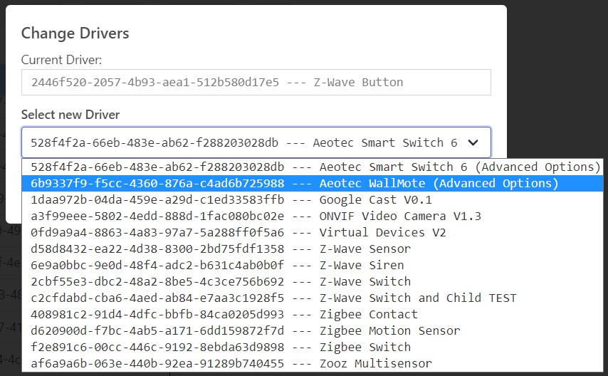

So I then tried using the API Browser to change the Wallmote’s driver but after selecting CommanderQ’s driver from the list and clicking ‘Change’, I’m met with a “Driver change failed with HTTP error 400” message.
Why am I not able to change this driver? And further, why isn’t the driver I installed shown as an alternative option for the Wallmote?

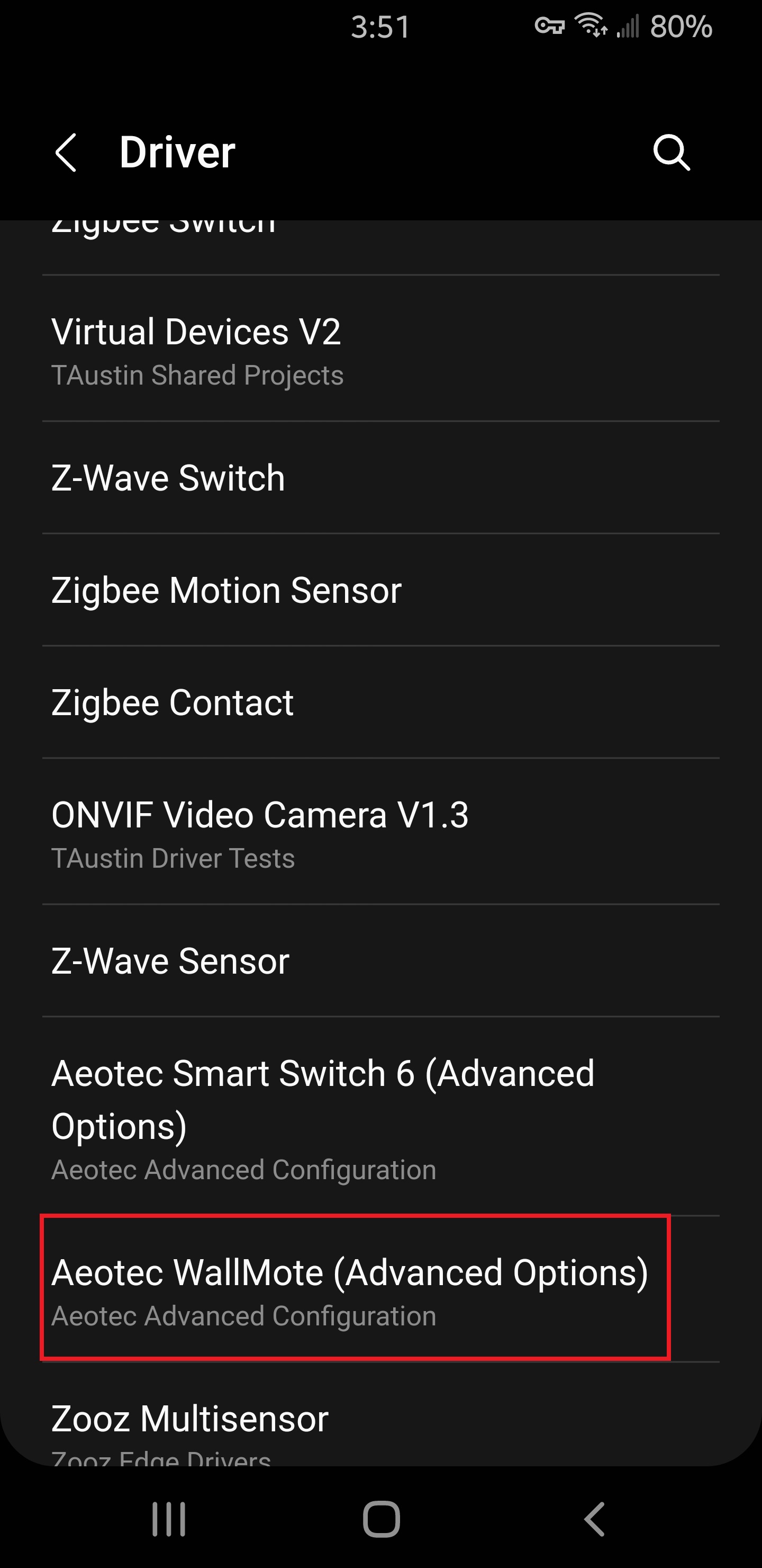

Does the driver show up in the app for that device when trying to change drivers vs using the API Browser?
No, still isn’t listed as alternate driver for the Wallmote. Also double checked the ST app to see if the Aeotec WallMote (Advanced Options) driver is shown and it’s there.

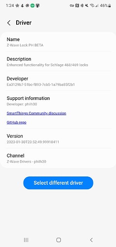

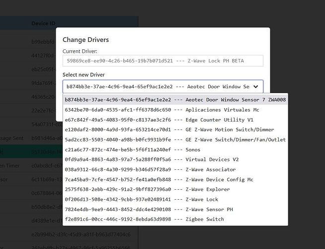

The API Browser doesn’t know which drivers are applicable to which devices and lists all drivers installed on your hub. The ST app knows which drivers have fingerprints that will match your device so you should check in the app to see what drivers it thinks will work with your device. Here is an example for my Schlage lock:
ST App Changing Driver
API Browser Changing Driver
