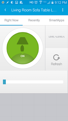

The problem is that when I execute this task, it appears SmartThings actually receives the String “%level%”:
The GUI actually displays the String “%level%” and the lamp is unchanged. If going back to my “A Thing” and replacing the variable “%level” with a hard-coded number, everything works just fine.

Thanks for the detailed notes and screenshots! This is fixed in the latest SharpTools release which is currently with the test group. You can join the list of testers by following these instructions (otherwise I would expect the update to roll out to everyone over the next week or so):
