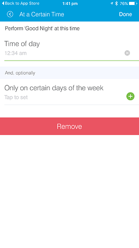

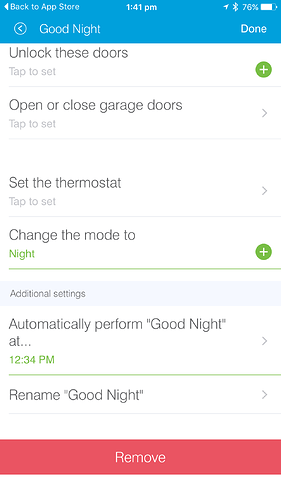

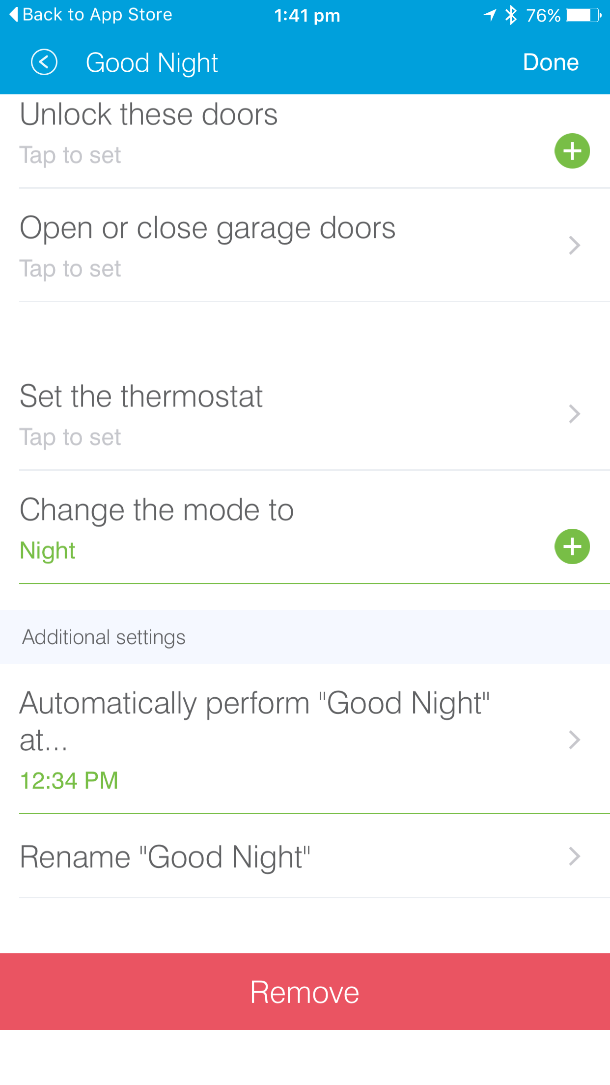

I’ve set good night routine, to switch on arm (stay) at 12:30am, but when I save it, it saves and runs at 12:30pm. If I set to 1:01am then it works.
Is this a bug? Can someone else try it please.

You can almost check straight away. I’m on iOS btw. Set it then go back into settings of the routine and first screen you’ll see the time, it says 12:30pm, then go to change and it shows 12:30am.

Anything after 1am is fine but 12am upto 1am doesn’t work. Can anyone test and check for me please

My iPhone is in 12hr setting, latest app, latest firmware. I goto the inbuilt routine, set “goodbye” to trigger at at time. Using the dial to set the time no matter if I set am or pm it shows am, it doesn’t move the dial.
I’m stumped, reset my original hub, been sent a different one, set this up, same.
Can someone try please and see what happens on the screenshots as this is so annoying.
I’d be grateful if other iOS users could try this, I’ll try and make a video to show the exact concern, but hopefully can see from the above screenshots.
Basically in 12hr on my iPhone, when editing routines for specific time, even if I go into pm it stays on am.
