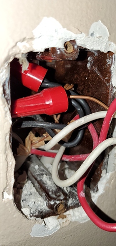

I have two LED lights controlled by 4 On/Off switches. The set up appears to be 2X three way switches and 2X four way switches. . As far as I can tell it looks like there is ground available in each box and it looks like neutral is roughed into each box. I am looking for a good dimmer solution. Please advise. Thank you.

Zooz ZEN27 dimmer supports 3-, 4-, and 5-way without replacing anything except the switch with the line.
As long as you have a neutral in one of the boxes with the 3-way switches, you should be able to use the ZEN27 dimmer here, it will probably be the easiest installation and the most affordable product here. We also offer custom wiring instructions if needed
What we’re looking at above is a picture from a 4-way switch so the white wires you might have interpreted as neutrals are actually your traveler wires. It looks like the black wires connected together are carrying power or load to the last box.
