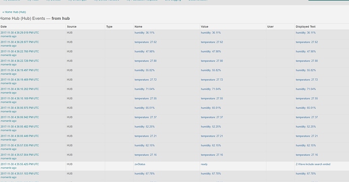

I believe I was able to pair my device however I only notice the sensor information showing in the IDE Events List and nothing on the app. Anyone have an idea on what to do?
Screenshot from app.
Which DH are you using? And what do you see in your device list?
I started with the Xiaomi one but switched to the SmartSense DH mentioned in your post, which has gotten me further with the pairing than just the Xiaomi DH. I’m going to try and delete the existing pairing and try fresh with the SmartSense.
