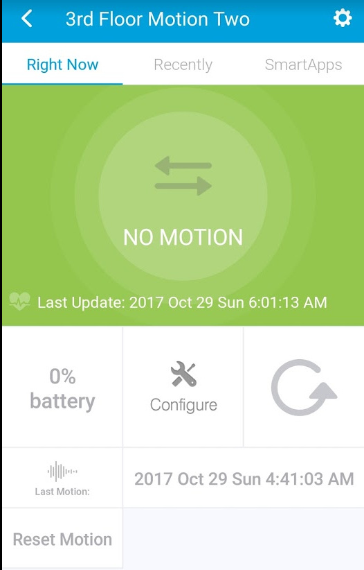

I installed 2 Xiaomi Aqara Motion sensors and they don’t report any battery values. So the ST health check keeps on telling me that they are out of power.

Not sure what is going recently with people adding the sensors. Is everyone using catchall? I would avoid this method and persevere with adding them via the App directly as a Thing. The catchall method assigns a temporary Network ID which WILL change if the sensor loses contact with the hub temporarily or even if the hub is rebooted. Using the proper method it picks up the unique sensor ID. I have about 30 Xiaomi sensors ALL of which are rock solid (well bar one which is very far from the hub and drops off once in a while, quick few presses of the button and it is back though)
Also, if you have ANY other hard Wired Zigbee devices (sockets, bulbs etc.) then Unplug them from the mains before adding any of these sensors. Zigbee will route through the closes available gateway which in turn can cause issues, you want to initially pair them directly with the ST hub so take everything else out of the equation.

I would remove the failed ones from ST. Then in the app just hit the add button. press the pairing button, wait a few seconds for the led to respond, keep repeating, eventually the LED will start to respond with 3 flashes, keep repeating, the sequence of 3 flashes will change slightly and it will appear in the app, rename if necessary and save.
If you have any other zigbee devices I would keep them turned off a little longer to make sure it handshakes correctly and stats to report batter etc. although this may not be necessary.
EDIT: Once removed from ST reset the Sensors, long press on the button until the LED stops flashing, release, wait 2 seconds then press and hold the button again, the LED will flash really fast, release once flashing stops.
