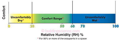

I made myself a Humidity prioritized version of @4refillpad s Temp/Humidity sensor - and came up with these background colors for humidity - hope it’s useful.
//AlecM 2017-07-04 - Adjusted background colors based on ASHRAE Standard 62-2001 “Ventilation for Acceptable Indoor Air Quality”
https://buildingscience.com/documents/reports/rr-0203-relative-humidity/view
backgroundColors:[
[value: 0, color: "#FFFCDF"],
[value: 4, color: "#FDF789"],
[value: 20, color: "#A5CF63"],
[value: 23, color: "#6FBD7F"],
[value: 56, color: "#4CA98C"],
[value: 59, color: "#0072BB"],
[value: 76, color: "#085396"]
