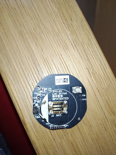

Has anyone tried connecting anything to the pinouts on the 1st gen version of the Xiaomi button ?
They have a Grd and a DI+ connection on the boards and I tested 2 peices of wire loosely attached and when they short it sends a pushed action to SmartThings.
So I’m hoping I can use that to create this Smart(ish) doorbell I’ve seen HERE
