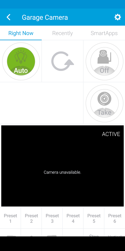

I am having issues getting my 9821 to work with this device handler. I can view camera fine on Foscam and Owlr apps. But when look at through the Smarthings app it shows “Active” but when I tap on it it show! I have uploaded a couple screenshots. Admin/pass is correct and so is the IP, any ideas?
