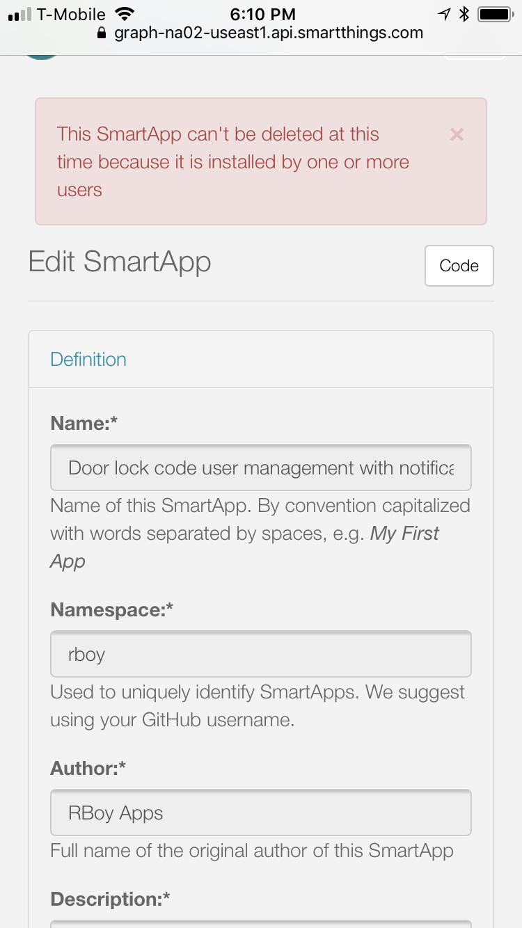

Not able to open smartapp ‘Lock multi …,relock’ v “07.02.01” [ "Door lock code user management with notifications and automatic relock ] to view settings, freezes smartthings app just spinning/reloading icon but it seems to be working (e.g. re locks with delay ). restarted smartthings app, reinstall smartthings classic (this time second pic after reinstall of ‘classic’, not sure why they decided to remove upper icons with time and signal but separate issue) and nothing. All other apps listed in smartapps tab can be opened with no issues.
Did you keep selecting the SmartApp from the Marketplace after you initially installed it? You are only supposed to select from the Marketplace the first time.
Once you have initially installed the SmartApp, then you goto Automation/SmartApps to access from then on after. You should only have one instance of it. What happened?
