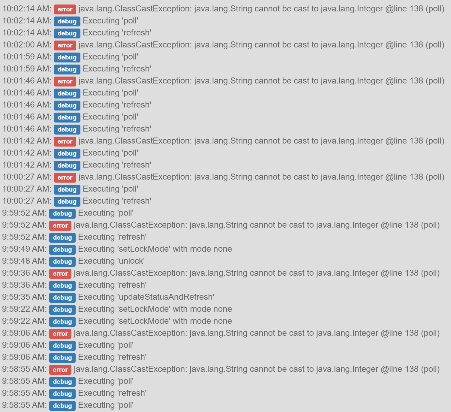

@Alyc100 I have installed everything and can control the lock functions through the SmartApp in ST Classic, but none of the other fields (e.g. battery health, curfew status, etc.) populate. The icon to the left of the refresh circular arrow is a ? with the word UNKNOWN. I tried to open the Sure PetCare (Connect) SmartApp, but after a few spins of the status wheel, nothing opens.
Lastly, do you know if the lock status is compatible with Action Tiles? I’ve made the flap’s lock status available to Action Tiles, and it lets me add it to a panel, but just displays a ? there too.
Also, there is a consistent error in the logs that seems to prevent syncing across apps (see screenshot).
