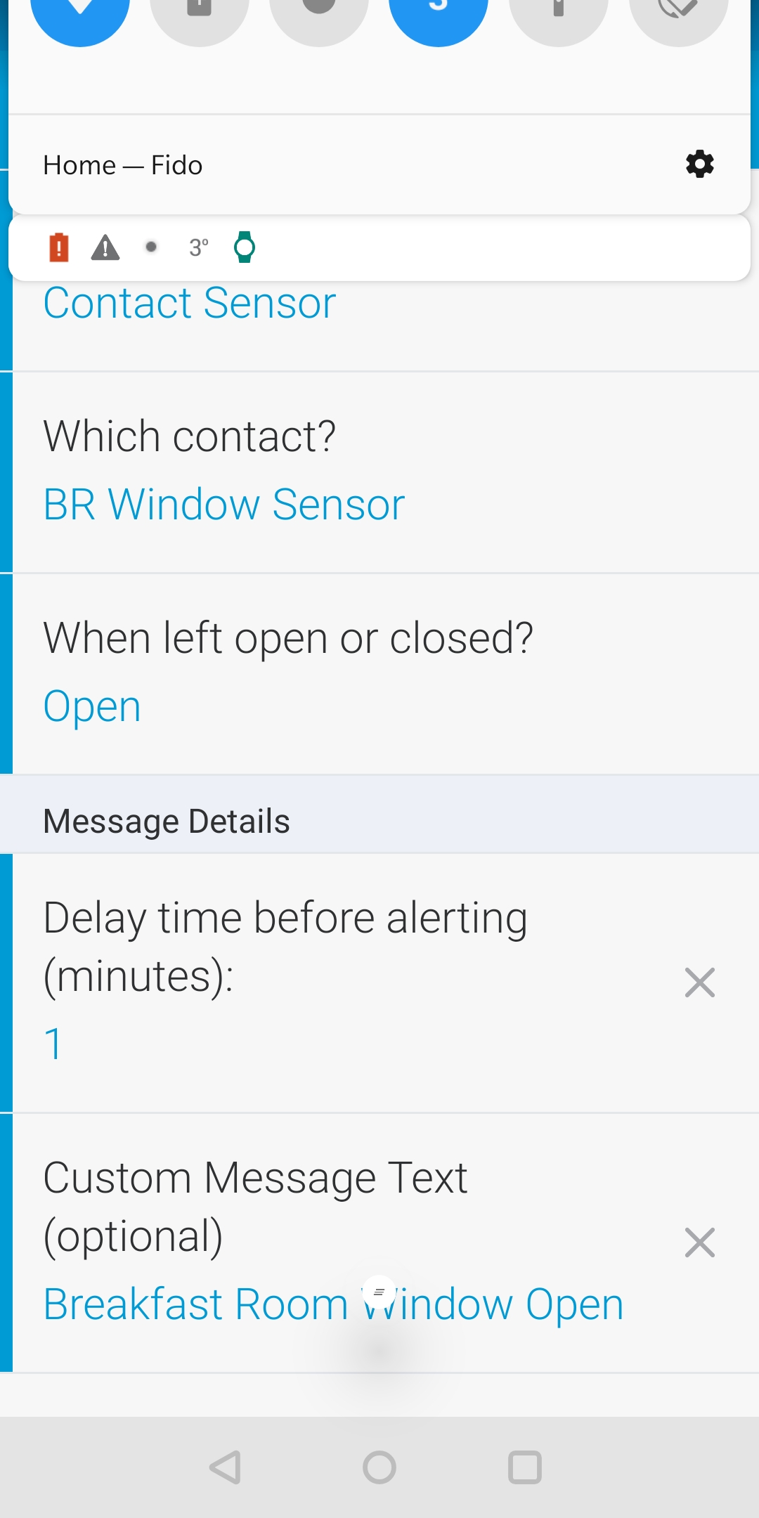

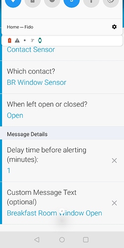

I want to have many child apps run, at a specific time of day, to check to see if a contact sensor is still open.
Well, in testing, I left open that specific window, but it fails to notify me.
The log shows the following:
822496f0-49e1-4a38-9684-60285ed80afa 2:32:01 AM: info updated with settings: [messageText:Breakfast Room Window Open, snoozeSwitchOnOrOff:Off, useTimeStamp:true, waitThreshold:1, modeChange:false, speechDevices:[Google Assistant Relay Speech, Home group], periodicNotifications:true, starting:2019-01-09T02:30:00.000-0500, endingX:A specific time, controlSwitchOnOrOff:On, sunChange:false, snoozeSwitch:Sensor Switch, monitorType:Contact Sensor, speakNotifications:true, myContact:BR Window Sensor, controlSwitch:Sensor Switch, phone-0:false, startingX:A specific time, modes:[Home], openClosed:Open, wantsPush:true, ending:2019-01-09T02:35:00.000-0500]
6b07c0f8-532e-4

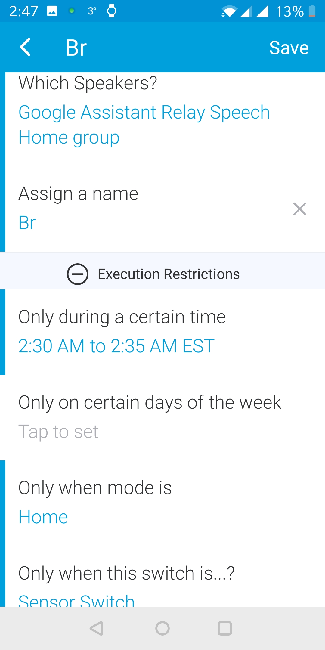

The specific sensor is called BR Window Sensor, and I set it to notify me as well as a message on my Google Home. I left open this sensor, and set the execution to be at 2:30AM.
No notification, and no message on my Google Home.
Can you spot any issues?

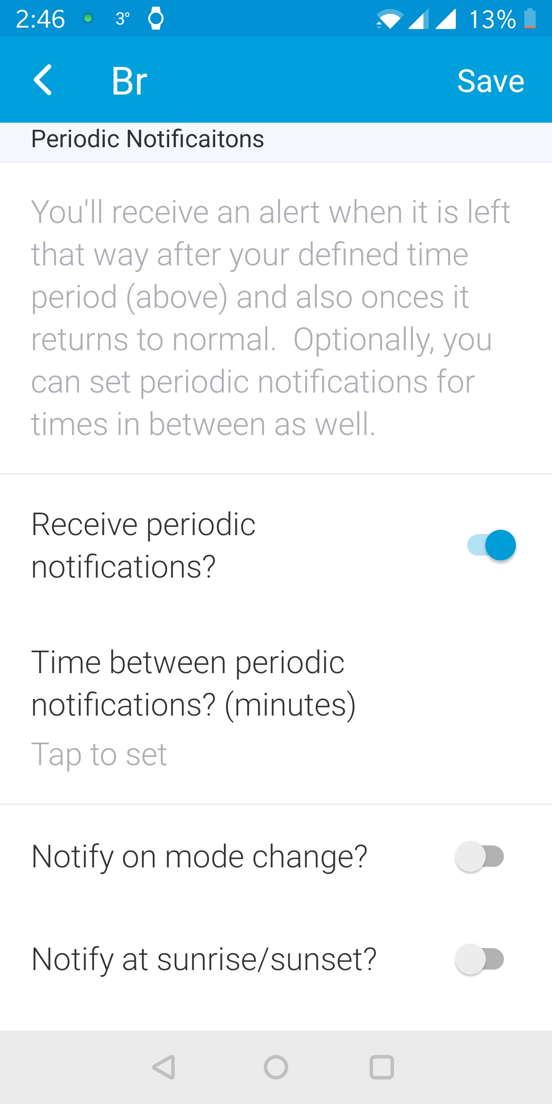

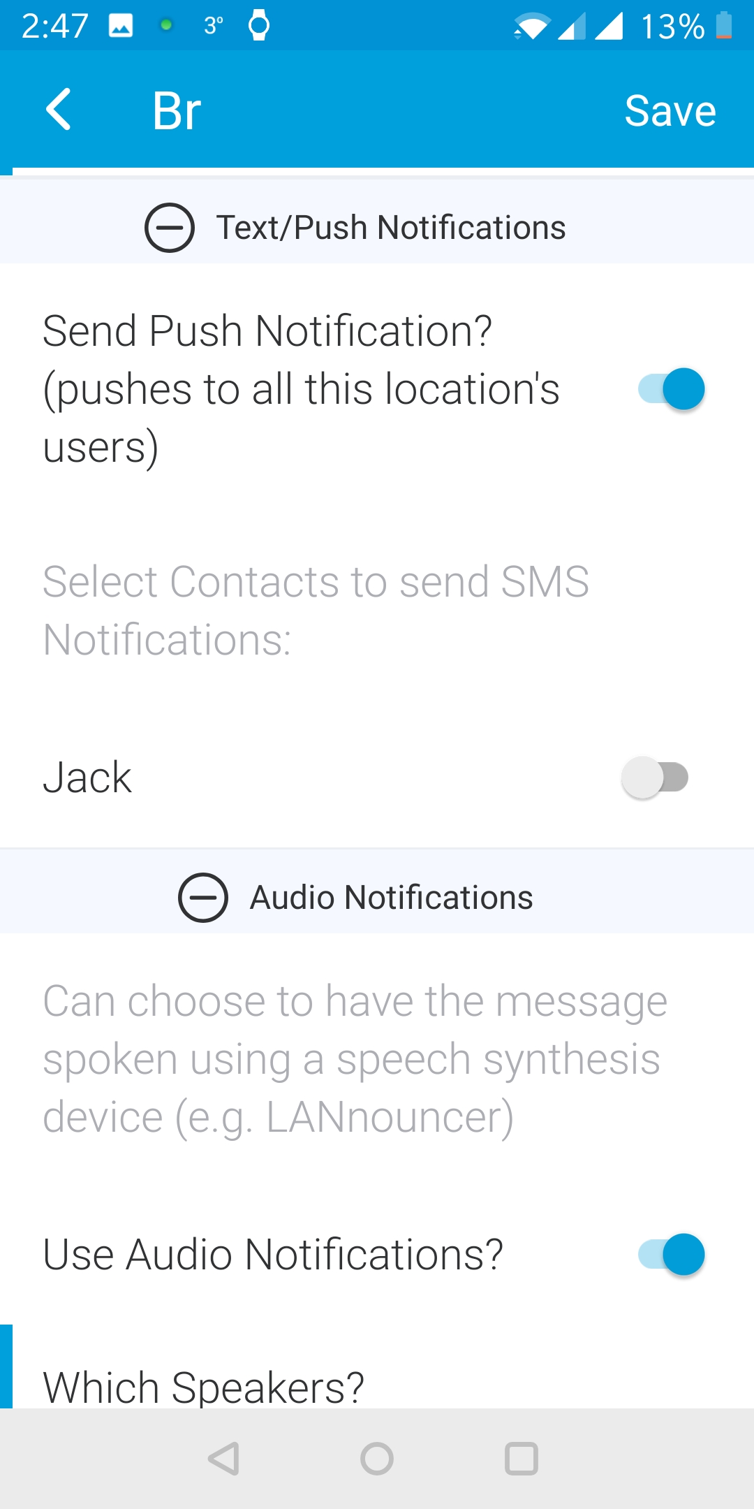

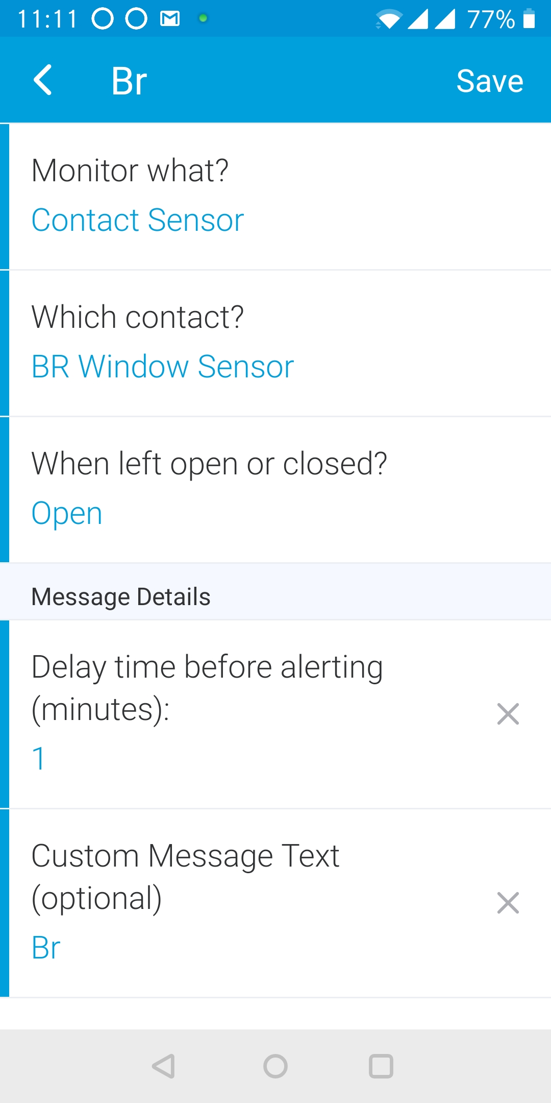

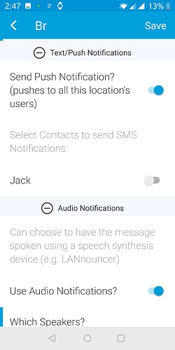

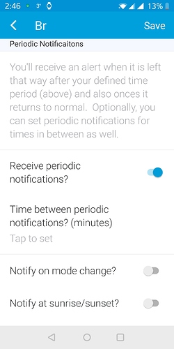

I am also attaching some screen shots of the input parameters:
Longshot but at that time is smartthings in away or night mode or I guess anything but home?
Nope. In Home mode.

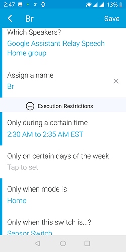

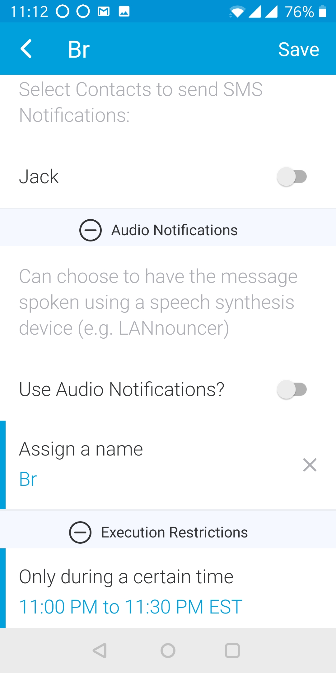

in the last picture, the one with your restrictions, the bottom of screen is cutoff. It looks like you have a “Only when this switch is…?” setup. I can’t see the last setting, the way you have it set up, you’ll only get a notification if that last switch is on or off (whichever you chose) while your window is open and the time is between 2:30 and 2:35.
Long shot there, but everything else looks just fine. Let me know; we’ll figure it out!

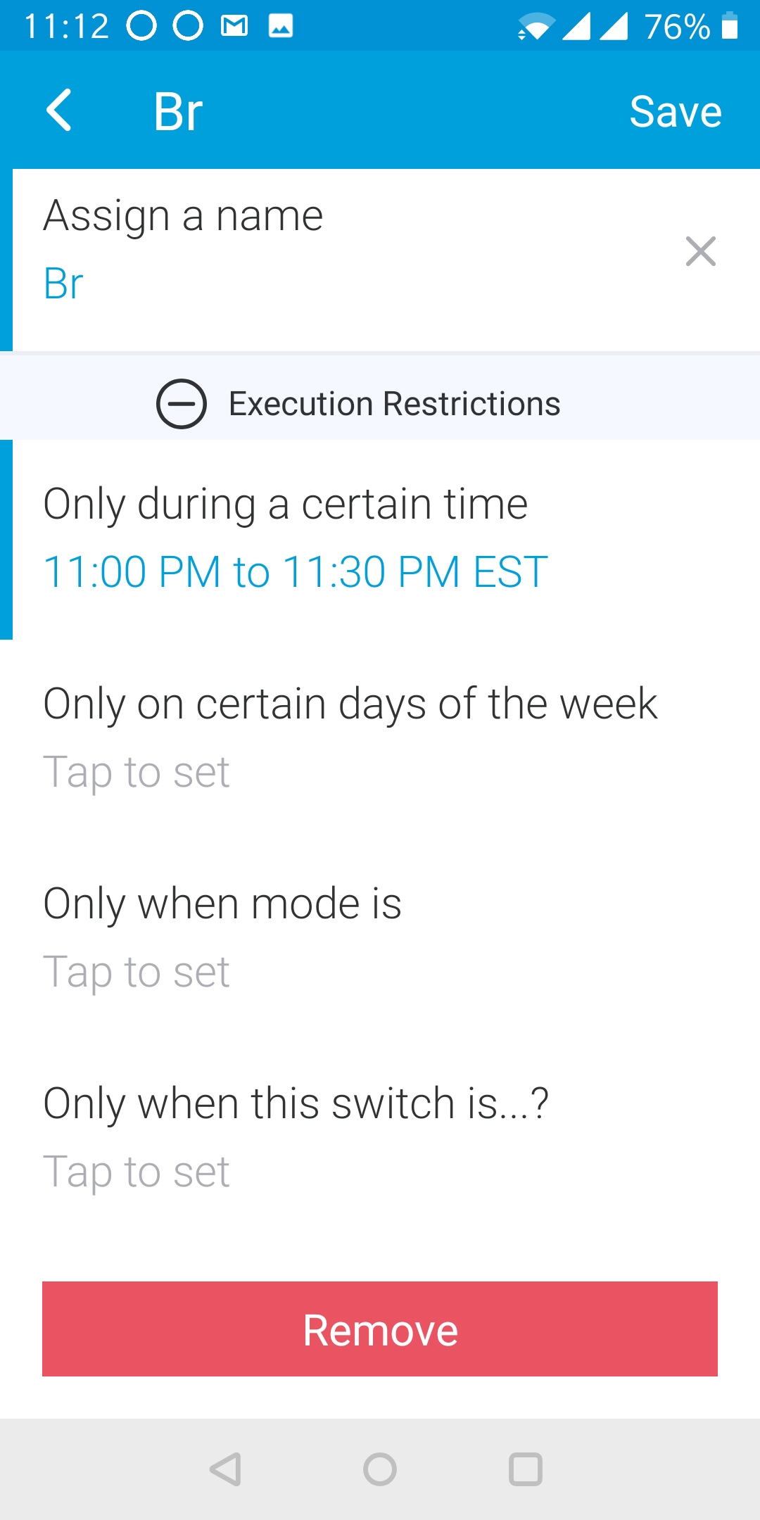

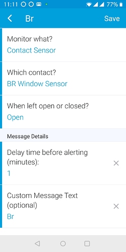

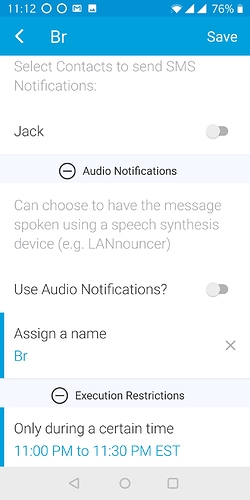

    I’m attaching a revised set of screen shots.

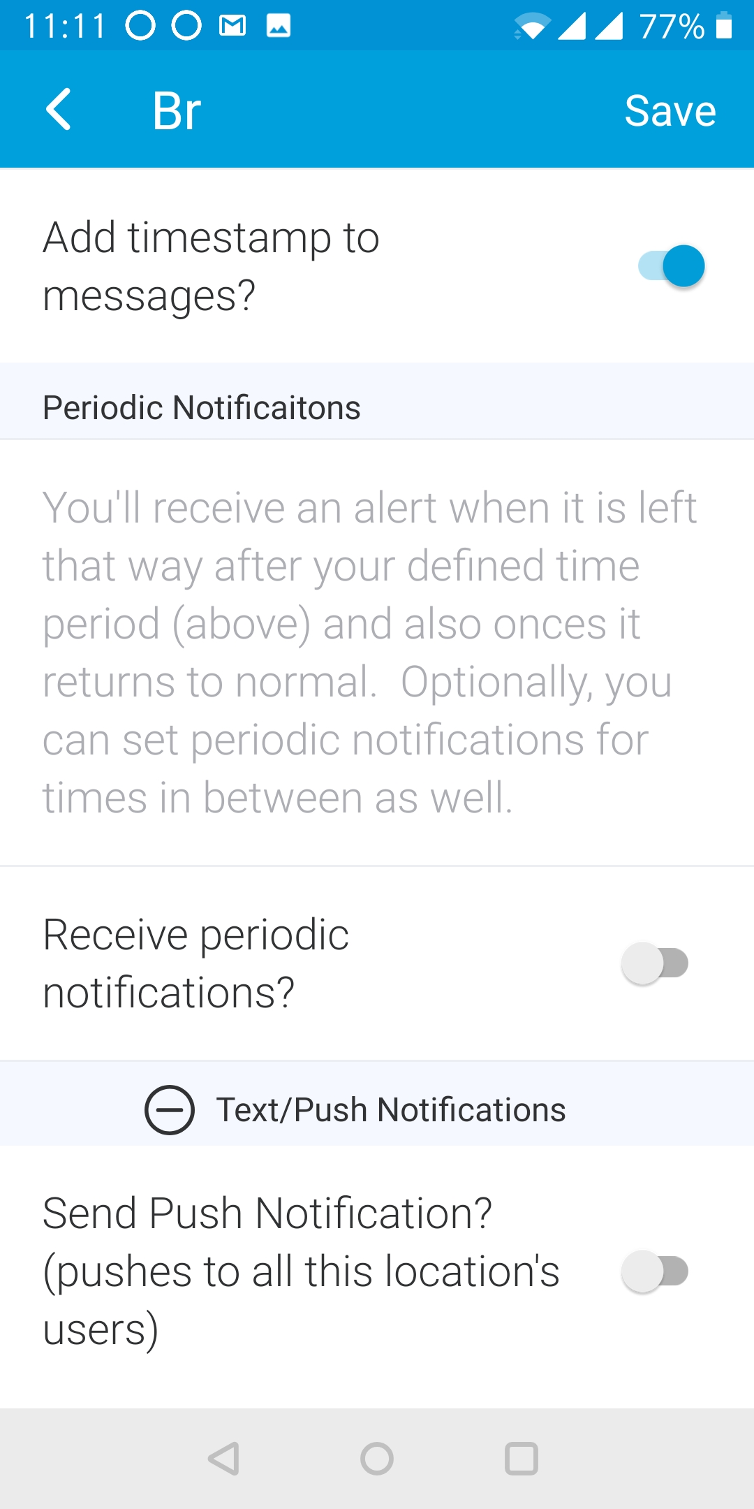

Well this one is easier. You have “Send Push Notification?” off and “Jack” in “Send Contacts to send SMS Notifications:” is off as well, so it won’t send either. You had “Send Push Notification?” on in your earlier post, so you should’ve been getting push notifications, but you need to make sure you’ve allowed the SmartThings app to send you push notifications within your phone’s settings too. Let’s do a couple things to try prevent a lot of back & forth:
1)I’d turn both push and SMS on to eliminate any other issues
2)Verify your phone number is entered correctly in the main Super Notifier settings. Assuming you’re in the US, it should be “12223334444” (countrycode-areacode-number)
  1. PM me your debug log: First, turn on the “Debug Logging On?” setting by clicking on the “Advanced” section at the bottom of the main Super Notifier settings page. Then go to the SmartThings API logging page on your computer. Change the settings to notify you if the window is left open during a time window you’re about to be in (so you can capture the logs and not have to stay up late), but make it for a time in the future (5 minutes or something). Save settings, so that the debug log shows them, and then open the window. Wait until the time arrives, give it the respective 1 minute delay time you have in the settings, and watch the log. If you don’t get any push or text notification, screenshot the logs and PM them to me, and I’ll see if there is something in there.
Sorry you’re having the issues, I haven’t made any changes to this app in quite a while, and it’s been stable the whole time, which leads me to believe something in your settings wrong. I’d also recommend adding an instant alert to that window opening, just for test purposes, and see if you get notifications from that. It’ll help narrow down whether its a notification sending issue or something else.
