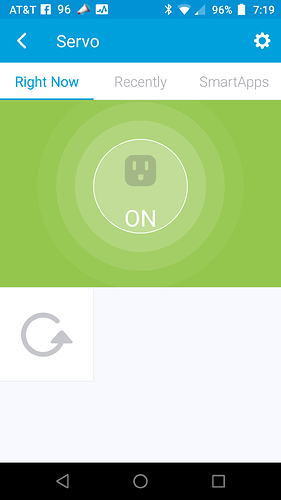

When that button is pressed. Charlotte needs to go 180. I do believe that is a switch function indicated in my coat above.
You need to do some more basic understanding of how Arduino code works and how ST works. You are trying to jump to level 8,398 when youâre on level 5. Take things a little slower.
In order to get ST_Anything to control a servo, you need to build a sketch that uses the Servo library and the functions within that library. It isnât as easy as you claim.
When I get back home I will post some code that I found that works to accomplish the task but does not use St anything. And donât know where to change in that code to adjust the servo.
Are you even reading my replies? Itâs not that simple as just âchanging some codeâ to insert what you found. You remember when you downloaded the ST_Anything Library for the Arduino IDE? Well, in there are all these .h and .cpp files. For example, IS_Contact.h. This is the file that defines how a contact sensor works. It is then called by the rest of the functions of ST_Anything. The âContactâ part is the capability. You would have to take the code your found and convert it into a ST_Anything capability. You would then have to create a new child device type and then modify the parent DTH for the new child.
So, itâs not as easy as âdropping in some code.â Do you understand how complicated it is now? I tried to do exactly what you are asking to do a couple months ago and it was WAAAAY too complicated to even bother with. I posted a sketch that allows the capability of ST anything and blinds with the other DTH. Why not use that?
