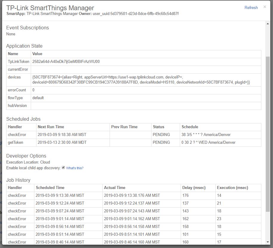

a. Log into the IDE.
b. go to “My Locations” and select your location
c. near the bottom is "Installed SmartApps: List SmartApps. Select this.
d. at bottom is Other. Select “TP-Link SmartThings Manager”
e. Under “Application State”, I need the data in the devices cell.
Here is the data under Application State:
{50C7BF03F275={alias=Audrey’s Bed Side Lamp, appServerUrl=https://use1-wap.tplinkcloud.com, deviceIP=, deviceId=8006A7B2BDDF29197AD33AF077B509241755B877, deviceModel=HS110, deviceNetworkId=50C7BF03F275, plugId=}, 50C7BF082537={alias=Living Room Lamp, appServerUrl=https://use1-wap.tplinkcloud.com, deviceIP=, deviceId=800690705F9DA02D59862C72622D972517824D93, deviceModel=HS100, deviceNetworkId=50C7BF082537, plugId=}, 50C7BF09F307={alias=Family Room Lamp, appServerUrl=https://use1-wap.tplinkcloud.com, deviceIP=, deviceId=800695475ECDDEA4CFD1333BDFD3000A175F5061, deviceModel=HS100, deviceNetworkId=50C7BF09F307, plugId=}}

Please help by one more indulgence. Do the following (all on the IDE).
- start liveLogging
- In a NEW window, go to My Devices and select a HS110 plug.
- Under the row “Preferences (edit)” select the “edit”.
- Change nothing. Just do a “Save” in lower right.
- You should see something like the below in “Current States” row of the Device’s page:
energy: 7 power: 0 DeviceWatch-DeviceStatus: online monthTotalE: 0.06 monthAvgE: 0 weekTotalE: 0.02 weekAvgE: 0
- If successful, let me know. If not, I will do a line-by-line review of the relevant code.
Note: I do not own a HS110 unit. I rely on users to assist in keeping it working and resolving issues. I use my LB130 as a testbed (it has energy monitor functions that I have coded for TEST purposes only). This device uses the same basic methods with the difference being the target method on the TP-Link device. It ran as expected using the steps above. When done, the Device’s IDE page should the following Current States:

- Open the phone app and go to the device detail page.
- Select settings (gear at top-left)
- Save (top-left)
- Observation: The six energy monitor tiles should now be populated (in about 10 seconds)
- Observation: the current usage button updates when the device is turned on/off.
