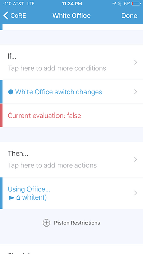

(jason buckley) #15
What I did for white was make a monetary button tile in the ide and then created a core so now I have it in Alexa and actiontiles
#16
Thanks for that. I didn’t think of a button.
Will try it later.

UPDATE: got it all working now. Thanks for the tip with the button tile and core.
