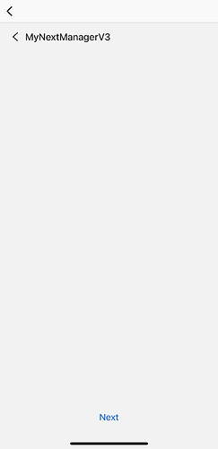

Any idea why I would be getting this error when trying to run the the simulation? Amal when I try to just use the installer it pops up let’s me select it then when I click next it’s a blank screen. I enabled the oauth.

I am done everything exactly as outlined. I even went back deleted everything (device handlers and smart app) and started over completely. I still get the same result when running the simulator.
The when I go to open it I get the initial screen everything looks good then when I click next I get this and it freezes on this screen. It is not showing up any of my devices and I have to force close smartthings after it freezes on this screen

I reset both of my reset and added them back a few time already. I even went as far as doing a complete factory reset on 1 of them to see if that would make a difference. I know smartthings can see the tstat because I see them in the device list in smartthings and I can control them from smartthings. When I load your up app, it always say 0 devices found.
It’s working now, what I did was copy the code in smartapp that I already created, then deleted the smartapp in IDE. I created it again. now it can see both tstat
Just tried setting MyNestManager again with the newest v3 code (was still using older code up till now) and got it working except for one problem. It can see everything in my nest account except for my thermostat. Any ideas?
