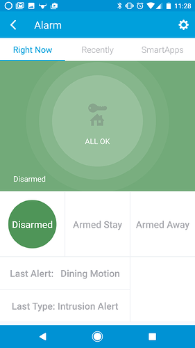

With SHM, I like the GUI. I currently see SA as being a sub program in SHM, so using it as my preferred interface is not desired. Unless it has a stand alone app that I haven’t seen yet. I would love to abandon one or the other. The delayed entry is my most desired functionality that SHM does not have.
In SHM, I originally thought the state (status) dashboard was the main control point. Then I found “Modes” in the Routines screen of the automation tab. I sense this is the intended control point which make sense for family members because it’s intuitive. For me, as the person who will be getting alarms while we’re camping at the beach, I like to just go to the state screen and arm/disarm as I need to. It’s more a case where I need to adapt to the intended method of using the app, which I am still learning. The fewer the number of interfaces and application links I deal with, the better.
