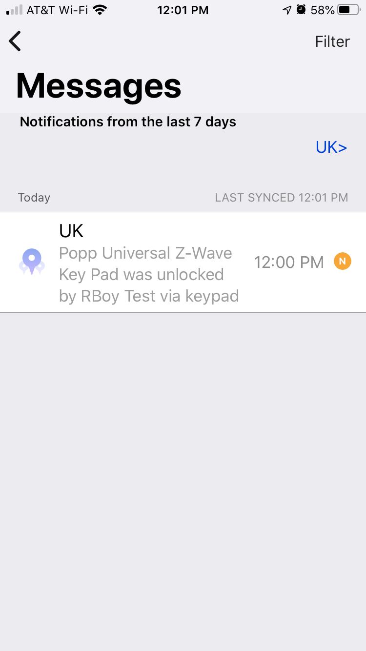

Messages page (SmartApp notifications) -> On the ST mobile app click on the Hamburger menu and then click on Messages. This shows all the messages logged by SmartApps. So this is where LUM logs it’s messages. Every time you get a Push or SMS notification from LUM, a copy of it is logged in SmartThings and can be accessed from this page. This is the only place where SmartApps like LUM and RLA can log messages. No devices/DTH’s can log messages here. (click image to enlarge)
TLDR; there are different sources of history, some from DTH’s, others from SmartApps. Be sure to read the above to see the differences and how they work.
