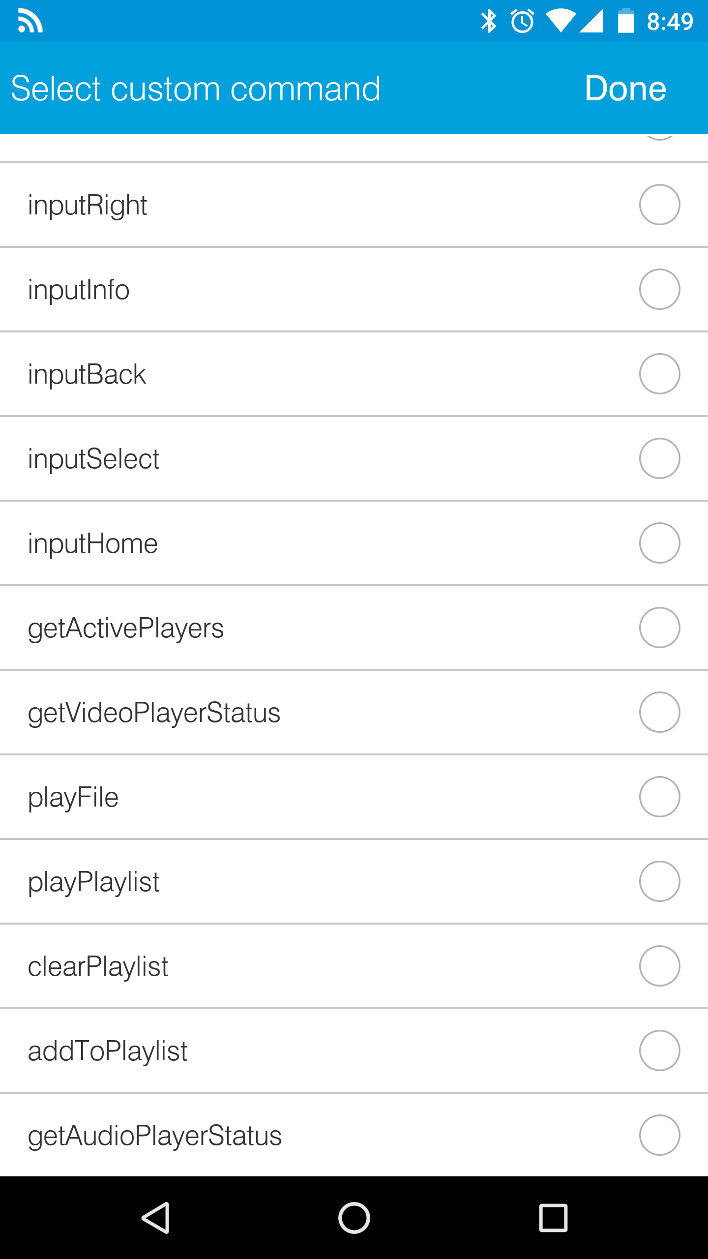

I still seem to be having issues… always the problem child. Sorry. I made sure i had the newest version of Rule Machine but I don’t see Kodi in the list of advanced commands. I also updated your Kodi device type but when I tried to update the smartapp I get the error below. Sure it’s something I did…Let me know what I can try.
groovy.lang.MissingMethodException: No signature of method: script1455991970903382135494.metadata() is applicable for argument types: (script1455991970903382135494$_run_closure1) values: [script1455991970903382135494$_run_closure1@8a6ced0]
Possible solutions: getMetadata(), getState(), setState(java.lang.Object), metaClass(groovy.lang.Closure) @ line 21
Make sure you grabbed the right code if you are manually updating it. You need the SmartApp code loaded as a SmartApp and the Device code loaded in a Device Type Handler.
Yep… must have clicked the wrong link. Got that fixed but I still can’t seem to see the advanced commands in RM. I’m going into RM… clicking on the advanced commands at the bottom which opens the test page. When I click to select a device Kodi isn’t listed. Am I in the wrong place? Do I need to do something else first?
Thanks again
Make sure you have the newest version of Rule Machine… under “Custom Commands”, the first item used to be something like “Test Device” and now you should see “Select capability for test device”, then after selecting Music Player as the capability, you’ll get the option to select the device, and then all the custom commands should show up.
