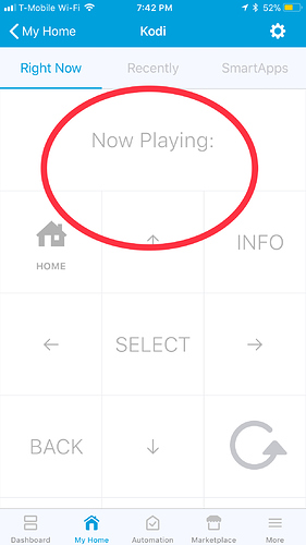

Control of Kodi works from SmartThings device created by smartapp, Kodi receives SmartThings notifications sent via webCoRE piston. What I can’t seem to get working is status of Kodi to show in SmartThings device. My next project was to create webCoRE pistons based on Kodi status.

I have the same issue. I have an Android box and the solution currently is to manually hit refresh at the bottom right of your Kodi thing after I start a movie. Seems to function until you turn off the android device.

So similar to this app I couldn’t get it to update but soon as I entered my IP and port into the IP overide section it then worked.
Great advice - That trick worked! Wondering one other thing: is there a way to see Kodi play status in SmartThings? Thinking about setting up webCoRE piston so when Kodi is playing it sets stereo to source and volume plus maybe when paused muted stereo.
Yeah I think it’s just called "playing"
You can tell by playing something and then going onto the recently tab and it will show you what the actions called.
