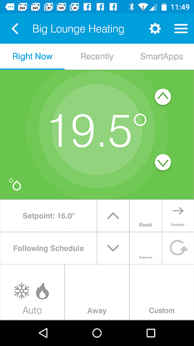

Can someone using David’s code on Android please post post a screenshot of a zone, particularly the big tile at the top. It’s looking very different here on iOS and Android, but I don’t know whether that’s down to something dodgy at my end, or whether it affects all Android versions.
LOL! Then it appears that multiTiles with type=“thermostat” are totally messed up on Android. I suggest you raise a support request to SmartThings about this.
It’s possible that removing the string type:"thermostat", might help…
I only have iOS myself, but if anyone with Android develops a cleaner tile layout, let me know and I’ll incorporate it into the code on GitHub.
Alternatively, if anyone wants to donate an Android phone…
Note, you can fix the question mark fairly easily by editing the device code, see discussion earlier in the thread.
Currently there is a parity issue between Android and iOS platforms in regard to how multiAttribute tiles work. There is currently work being done on the Android platform to address this. In the meantime, some things stated here about multiAttributeTiles may not work as expected on the Android platform.
For the time-being I suggest using type:"generic" on the multiTile for Android users. And changing key: "OPERATING_STATE" to key: "SECONDARY_CONTROL" on the tileAttribute. However the background colour will no longer update based on the operatingState.
Looks like the latest Android App update has fixed the problem of the up and down buttons and humidity icons appearing in the main tile. But I’m not seeing the status line either - although perhaps I messed around with the code! I need to do a refresh against the latest release.
