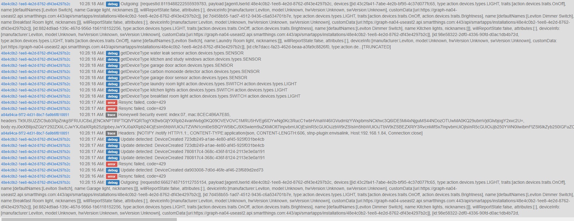

I am making progress. I was using the wrong proxy address in the smart app configuration. I changed it to the IP address of this windows machine and got the attached log. I now have repeating errors that say resync failed code=429. Not sure what this means.
There is a lot more in the log file that I could not print screen. I could copy and paste it to an attachment if this will help.
Any suggestions? Thank you for your help
Those errors aren’t related to this smartapp. There are only a couple of lines that are - the two that start with “a84a94ca” in blue. At the top of live logging, there are links for each device/smartapp that has posted a log since you opened the window. Use those to filter to one device/smartapp at a time.
