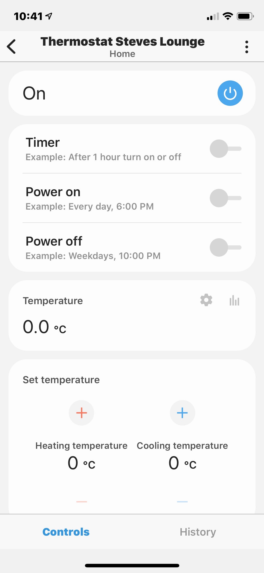

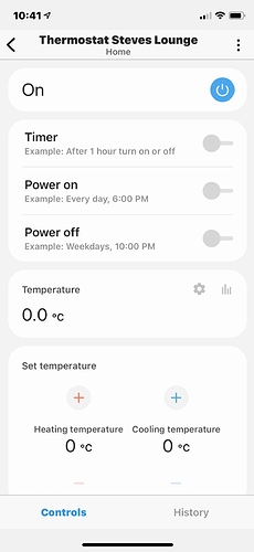

What errors do you see in live logging? I expect the child devices didn’t get removed completely, if the problem only happens on some devices with others working.
I ran live logging see below for Thermostat Steves Lounge
The current character read is ‘r’ with an int value of 114
expecting ‘}’ or ‘,’ but got current char ‘r’ with an int value of 114
line number 2
index number 36
“relaydevice”: “neostatSteves-Lounge”,
.^ @line 384 (parse)
Strange that some devices are working at all, but I think this error is the new Heatmiser firmware. Can you do an update using the firmware on my GitHub and the /update page on the NodeMCU IP address, that should get it talking to Heatmiser again
