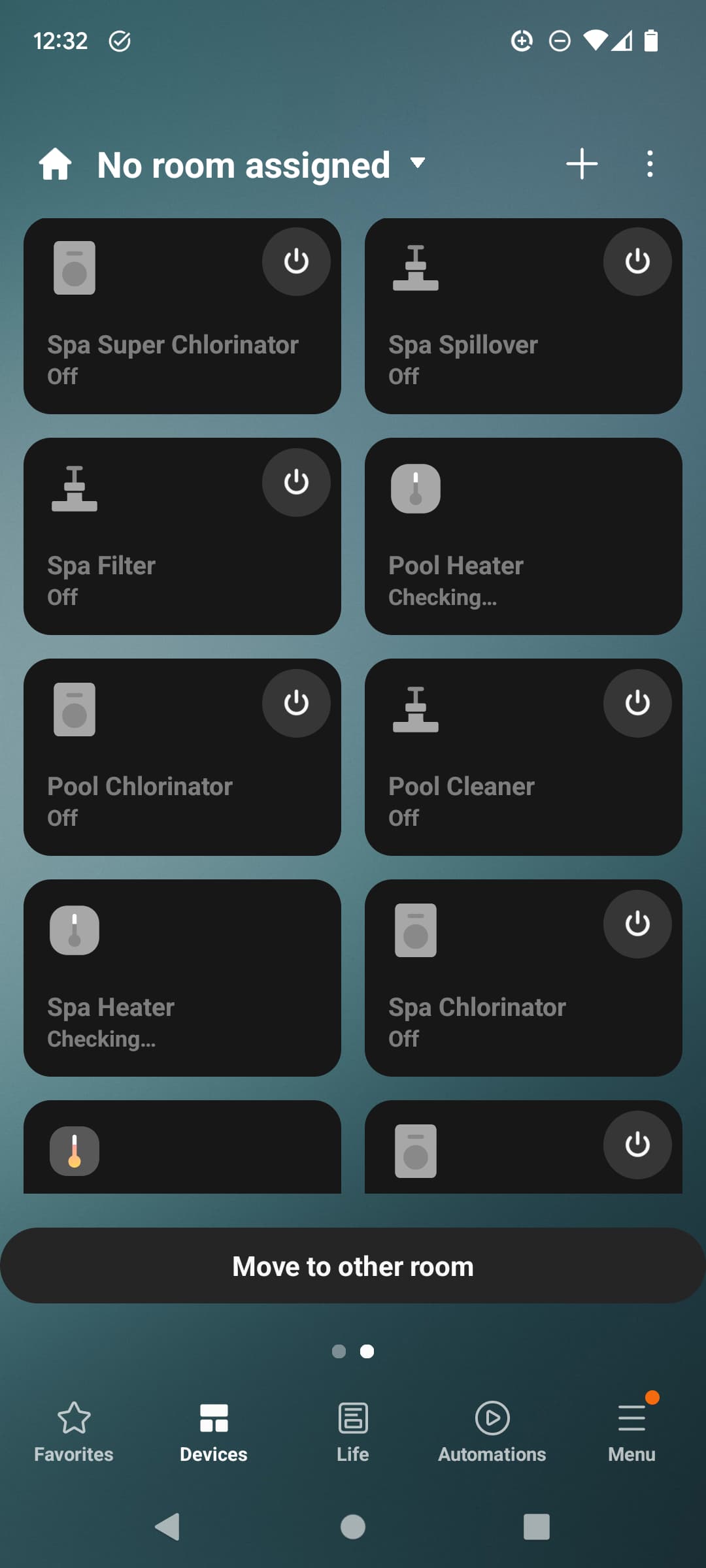

Hey @soupman98 I did add some icons (using ocfDeviceType
) but the icon set is limited and I couldn’t find a water heater icon, so for heaters it’ll just be the regular thermostat icon.
I also removed fan speed capability from the VSP driver. so now you can just use the % level.

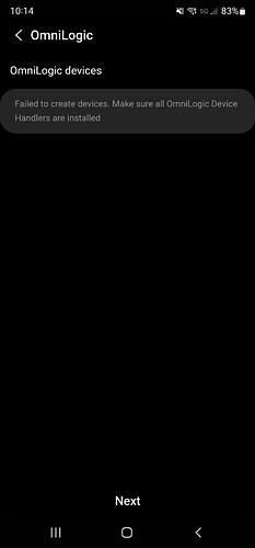

Hi. I’m having trouble setting up the device handlers. Below is a screen shot of the error I get. Not sure what I am doing wrong

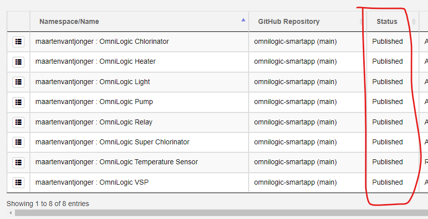

Make sure that all the device handlers are installed and published:
If that doesn’t work check out the “Live logging” section while trying to add the devices. It’ll let you know what is going wrong.
