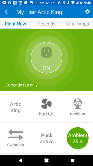

Hello, I was looking into the Flair Puck and it seems perfect! However, it appears that it doesn’t support dry mode even though it has a humidity sensor. I found this topic on Google when searching for a workaround. You mention it can set modes such as “on/off, heat/cool/dry/fan modes”. Are there any simple instructions I can follow to have a minisplit automatically activate dry mode if the humidity is above 60%.
