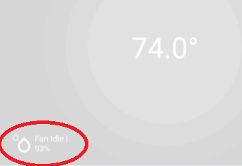

I’m not sure if this is by design, but I find it confusing that the battery percentage is being displayed in the bottom left corner next to the drops that I would associate with humidity.
The green 57% in your picture IS the humidity level. The battery level is not shown on that picture but is centered at the bottom of the screen if you scroll down. It is also in green but shows a battery above it.
Right, however, I am talking about the percentage displayed in the main tile in the lower left corner, which matches my battery level.
Hmm. Looks different from mine. I have an iPhone so maybe you have an Android?
Yes, I have a Nexus 6P. Actually, the other question I have is about the arrows on the right with a 0 in the middle. I assume that’s supposed to be the set temp? I like the idea, so when I look at my living room I can see just about everything without having to actually go into the device, it just doesn’t seem to be working right for me.
Those are issues with iOS Android app. It’s been reported to ST but feel
