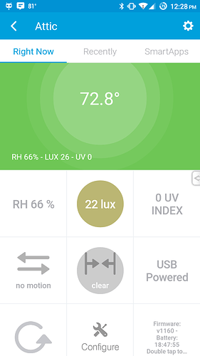

This thing also has lux and UV index but I can’t seem to figure out how to get that out of it besides seeing it on the SmartThings app
That would be cool. I would put one of these in every room and can get a general report of the conditions in any given room. Temp, humidity, light levels, motion activity, etc. I have a custom enhanced device handler for this device now after I read more into it. I wonder if I have to change something on that end.
