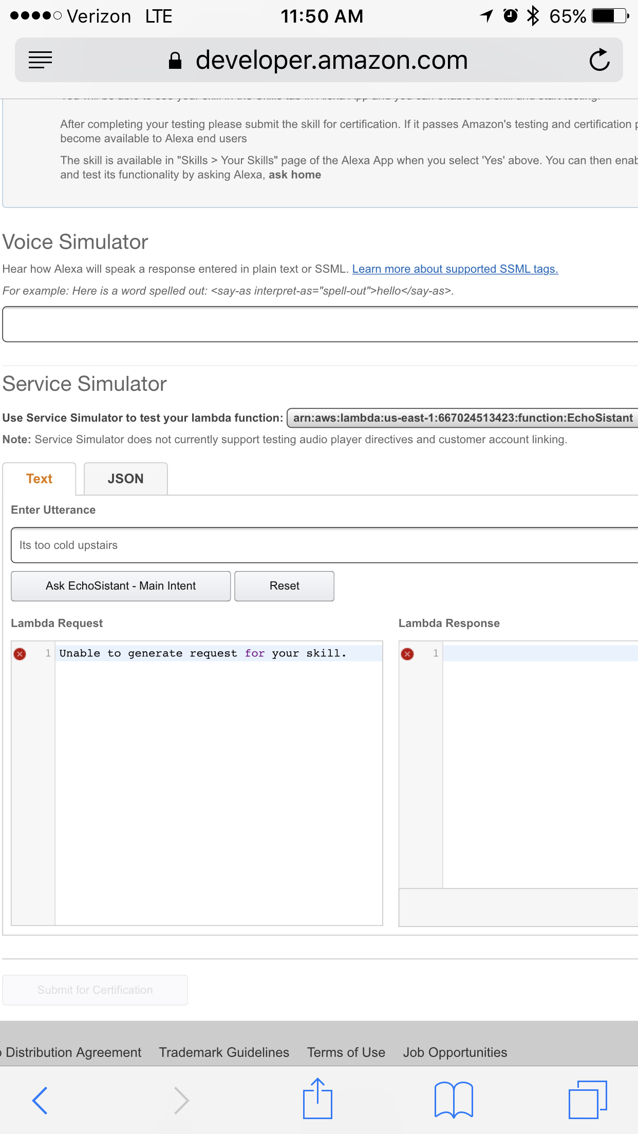

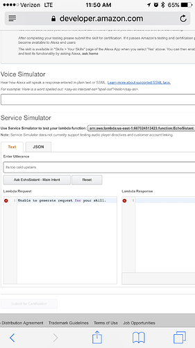

That’s the problem… there are no logs to post.
Whenever I say “Alexa, tell home its too cold upstairs” I simply get the ping noise.
I have a nest thermostat

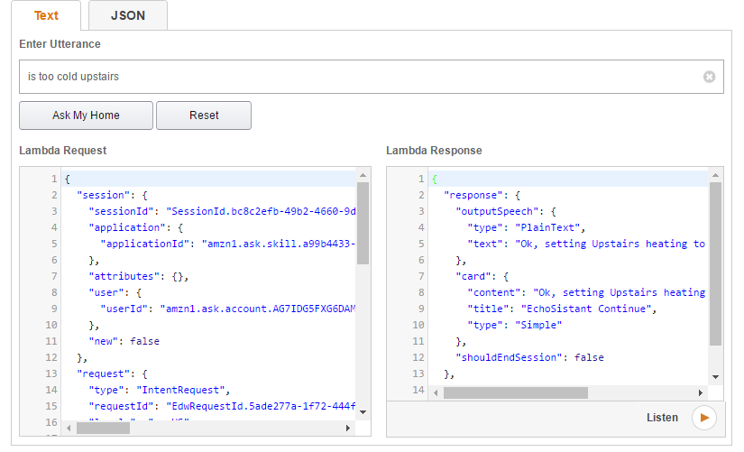

If I type the phrase into the developer simulator for the main intent the attached is my result.
Take out the tell home.
Type in…
It’s too cold upstairs
Also tried ‘it’s’

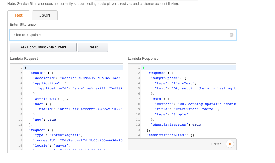

Could you please try one more for me?
WINNER!!! So… do I need to say “it is too cold upstairs” or can you all make the adjustment to allow for ‘it’s’.
Well, the ‘adjustment’ is already there. We are less fortunate that Alexa acts differently for us sometimes. I would just stick to Alexa is too cold…Or if you have patience (I don’t). You can first try it’s too cold and if that doesn’t work the first time, then just say is too cold.

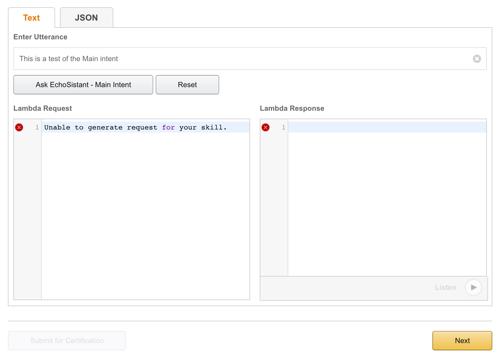

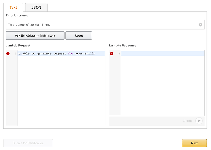

Thanks, got past that part. I can test and turn the lights on, but this part fails…
“This is a test of the Main intent”
Eric,
please make sure that you copied your ARN into the main intent correctly. Also, double check your tokens in the lambda

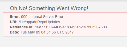

I see multiple updates in the “Update from Repo” but when I click the buttons and update, i keep getting the below error. Any idea why?
