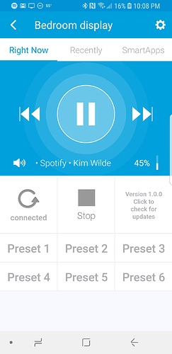

(Thomas) #842
I can control my devices (see chromecast playing), but when I select any of the cast-web-device, my phone goes black and it reopens “My Home” tab. Any suggestions would be appreciated
