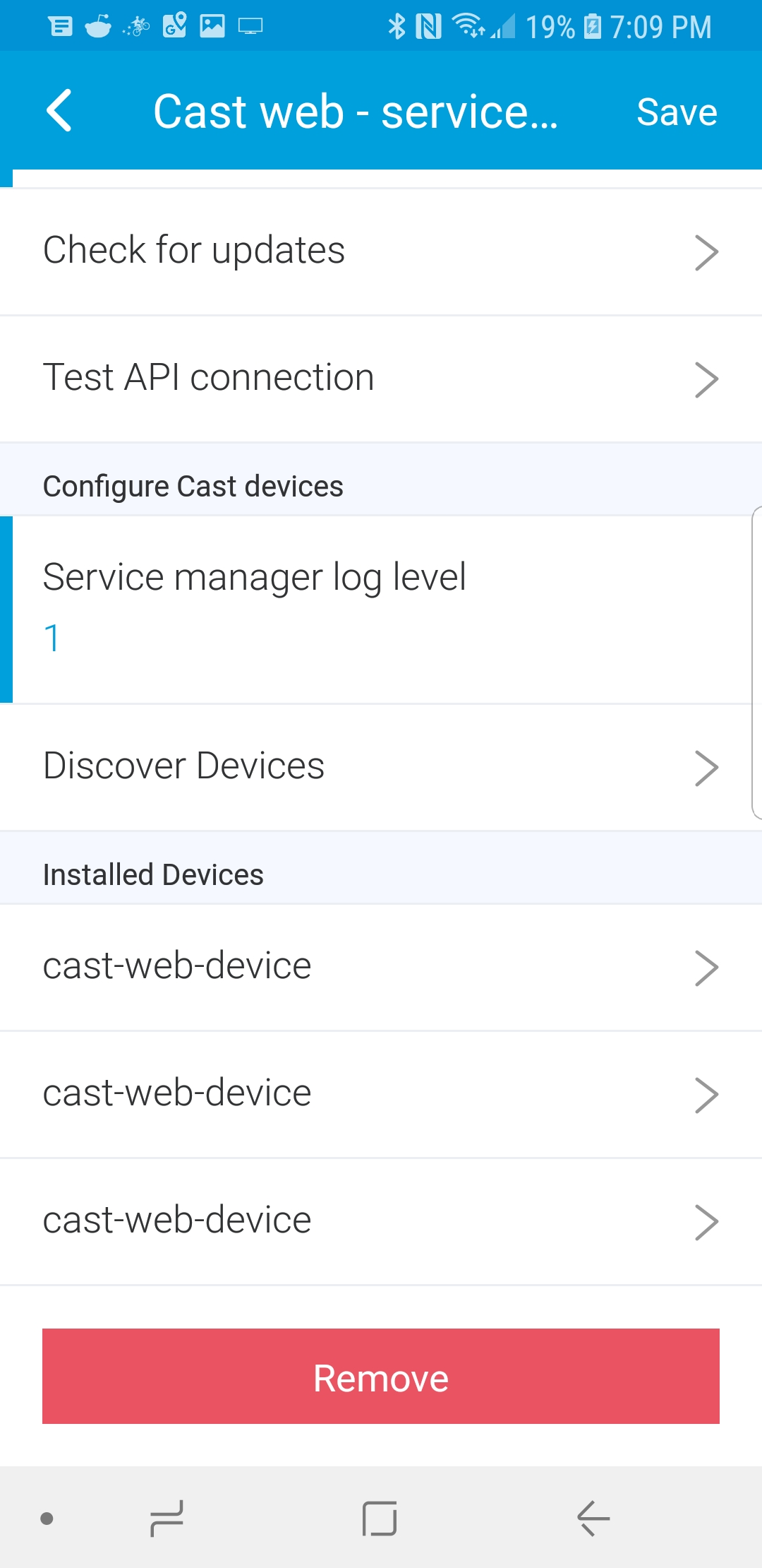

You can see here, when you go to search for devices, it finds 12. The 3 I’ve already added date listed there…
When you go in to select devices, you can see they’re all listed. I select the 3 bedroom devices and click next…

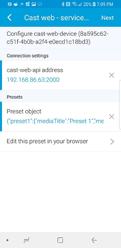

And I get this screen, which still shows me the devices by name and their IDs…
Click save on that and it successfully updates…
But then these devices are listed everywhere on this things list and within the smart app as just cast-web-device.
And you can’t rename them by clicking those, because it crashes out on the things list, and in the smart app, only brings you to this:
