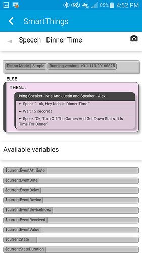

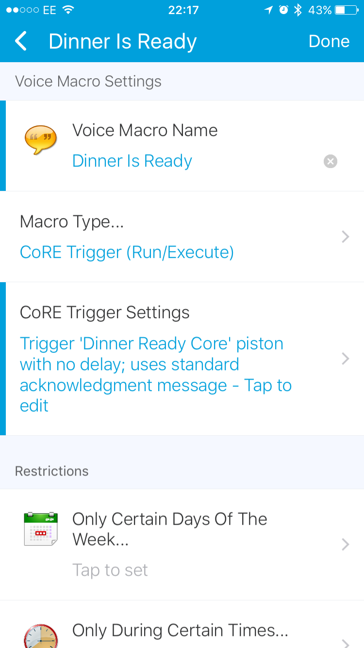

Okay thanks, I am trouble kinda bringing it all together. For example if I want to say Alexa, Tell My Home Dinner is ready and have a push message send to the phones connected to ST and flash the light.
I tried using CORE but when I set the core to run the piston when Ask Alexa Macro was executed nothing happened
In the Core smartapp change the piston from what you have to a simple piston that has a blank If section and only has the Then section configured… like this (your AskAlexa app is fine)…
@bamarayne initially I tried your suggestion and it didn’t work but then I looked at your screenshot closely and it seems I had the action in the wrong section, it needed to go into the Else… section rather than Then… which is where I had it.
I did the same thing the first time… This way works really well for me… I hope it does you too.
