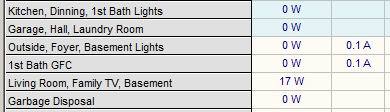

Small but measurable. From one engineering report on Hue:
When the bulb is on and set to maximum brightness, it consumes about 0.08-0.09 Amps (about 5.4 Watts). In the off state (but still drawing some power so that it can communicate with the network), each bulb draws around 0.01 to 0.02 Amps (about 0.4 Watts). As expected, even when the LEDs are off power draw is not zero. The ZigBee network controller and other circuitry need to remain active in order to listen for communications from the

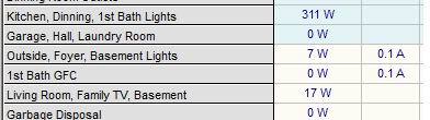

The wife called and told me all the lights are on full bright throughout the house. I spend more time babysitting this system then its worth. I am shocked this flaw does not effect more people.
