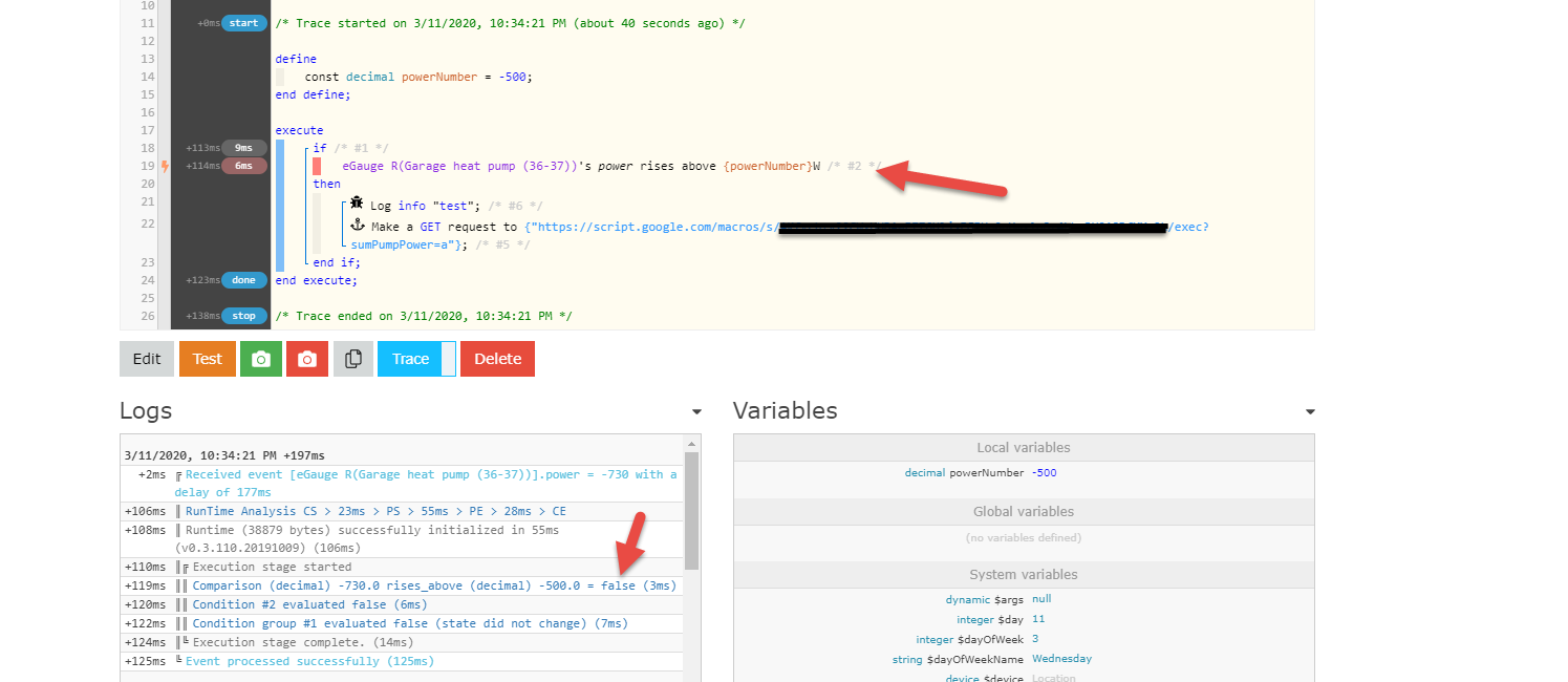

I have some device power which I’m trying to create a rule when it goes below a certain threashold but every time, the rule evaluate my condition as false. I’ve even tried both raise and drop and the condition in both cases is not being met. I this a bug or just me that doesn’t know how to use it?
I’m using WebCore v0.3.110.20191009 (which is latest version I believe)

‘Drops below -500W’ is a trigger condition and can only be true if the previous value of power was -500W or above. So what was the previous value?
Just to add @orangebucket’s question. Your example show the value -730 compared to -500, that is lower (below) -500, but dropped and raised are triggers, so it has to pass from one side to the other of -500, ie. drops below -500 will trigger if the previous value was -400 and the current value is -730. If your values all below -500, ie. -600 changes to -730,it will not trigger as it is already below -500, and not currently dropped.
@GSzabados : I see, thanks for the explanation. So if I want to only trigger everytime it goes bellow -500, I would need to use a condition instead of a trigger correct?
