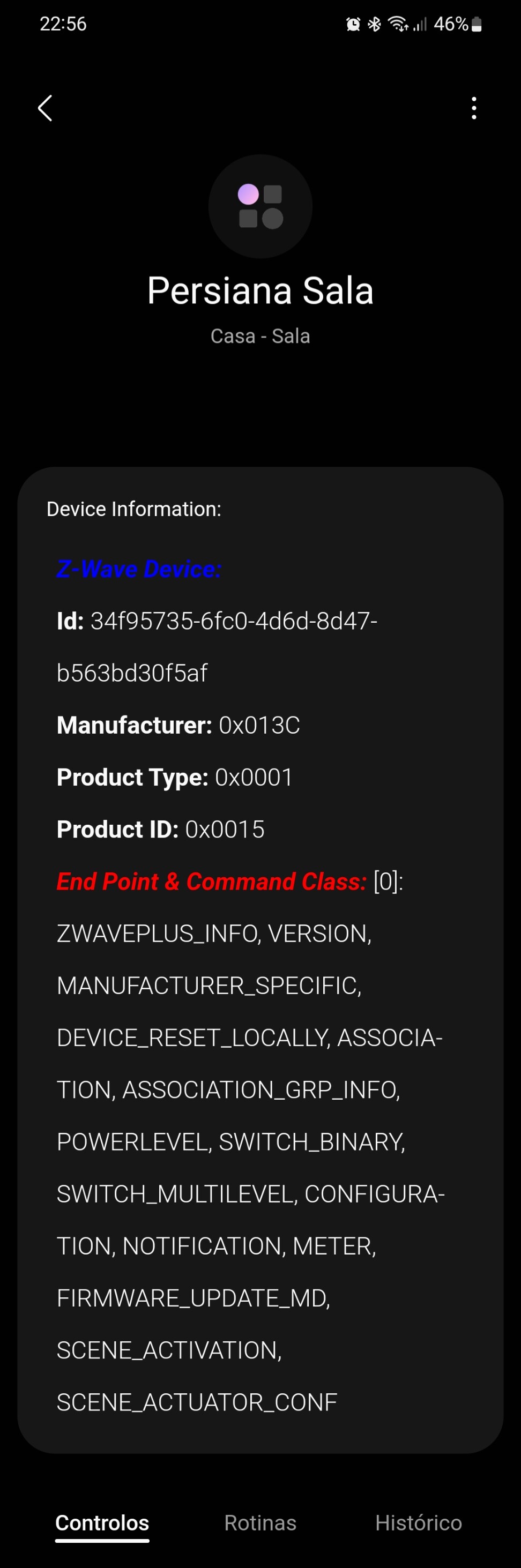

Guys I need your help…
I removed one of my blinds, to add again thinking it would show with the new Zwave driver Window treatment.
But the problem is that now it only appears as Switch and in the controllers it doesn’t let me choose the correct one
Can anyone help?
The print remains
If you click on the 3 dots in the upper right, is Driver listed? If yes, what Edge Driver was assigned? if you choose Select Different Driver… you can’t change it to the blinds drivers?
only drivers appear to me as if it were a Switch
I don’t see the blinds
did you check if the device has an Edge Driver that is in production yet?
brand/model? fingerprint from IDE?
my brand does not appear in the list of blinds
Is a Philio pan08
Hi @Helder_Rodrigues
I think you are doing the steps in the wrong order.
  1. How to check that the fingerprints of your device are in the fingerprints.yml files of the stock smartthings drivers
  2. If they are, then install the driver on your hub and uninstall the device and re-pair it with the driver
  3. If they are not in the stock or community developed drivers, then don’t uninstall device and wait for to add them or ask if they can be added.
Do not do it the other way around because this can happen to you.
Hi @Mariano_Colmenarejo
Well… I rushed…
My blinds don’t show up on fingerprints…
And I completely forgot that if it’s not there, it’s no use having the driver installed…
And this driver can you create?
For the blinds the only solution that comes to my mind is to uninstall the drivers add the blind again and wait for it to pass automatically…
