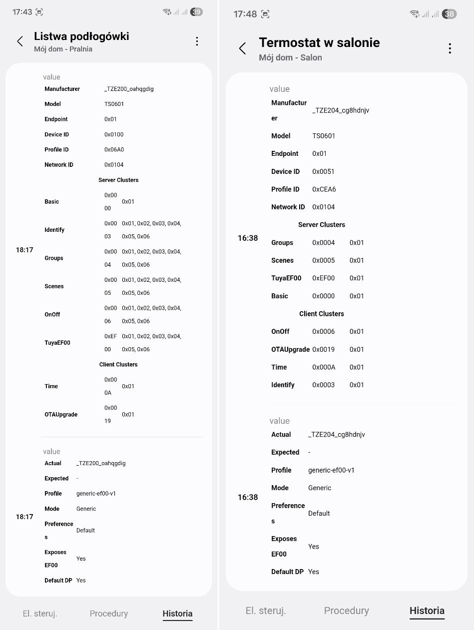

Hi @Mariano_Colmenarejo,
I would like to request adding fingerprints for two devices from Engo Controls to your Zigbee drivers. I am currently using them with your “Zigbee Thing MC” driver to extract the data.
Here are the details for both devices:
  1. Engo Control Box (ECB62-ZB) - Zigbee Multi Switch Mc:
Manufacturer: _TZE200_oahqgdig
Model: TS0601
  1. Engo Temperature Regulator (E25-BATB) - Zigbee Thermostat Mc
Manufacturer: _TZE204_cg8hdnjv
Model: TS0601
Fingerprints (Data from Thing MC):
These devices are crucial for floor heating control systems. The E25-BATB is a battery-powered thermostat, and the ECB62-ZB is a wiring centre/controller.
Thank you for your amazing work and support for the SmartThings community!
Update: Technical documentation and DP mapping
​I’ve managed to find the technical specifications for both devices in the Zigbee2MQTT and z2m database. This should help with the mapping for the Tuya EF00 cluster:
​1. Engo ECB62-ZB (Wiring Centre):
​DP 1 to 6: Switch status/control for zones 1 to 6.
​DP 101: Pump/Boiler status.
​2. Engo E25-BATB (Thermostat):
​DP 16: Target Temperature (occupied_heating_setpoint).
​DP 24: Current Temperature (local_temperature).
​DP 36: Battery percentage.
​DP 45: Temperature Calibration.
​I hope this makes the implementation easier.
Let me know if you need any logs from the Zigbee Thing MC to confirm these data points!
Important note on communication:
I’ve observed that these devices do not send a standard Zigbee acknowledgment (ACK) when using the OnOff cluster. This results in a “communication error” in the app, even though the status updates later. They seem to rely entirely on Tuya EF00 reporting, so the driver should probably be configured to ignore the lack of standard ACK and wait for the EF00 state report instead.
Mariano’s drivers doesn’t work with devices using Tuya custom cluster (EF00)
Try using w35l3y [ST Edge] Personal Tuya Devices - Generic EF00 Device
