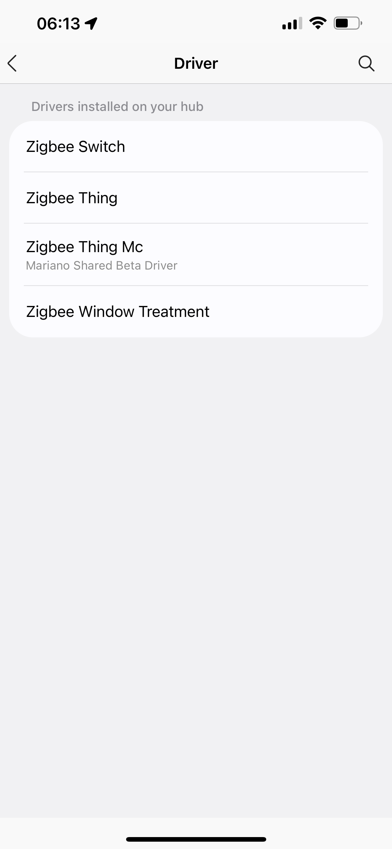

Need help with Tuya Curtain Shutter.
I added this to Smart things hub, but it’s not working properly. Can somebody help me to get the right driver for this please? I’m sending the information that I have below:
what driver you are using? have you try’d Mariano’s driver (invite link)?
What are not working properly?
I tried his drivers but didn’t work.
How we are suppose to know which driver you are testing if the driver’s name aren’t fully displayed in this image?
Please, be more specific! What is the driver full name, from which channel?
I’ll suppose you try’d using “Zigbee Window Treatment MC“ driver from Mariano Colmenarejo channel, this is the driver that i use with my MoES curtain module and it works very well.

Again, what is not working for you?
Those are the diver I tried.
Is there a place where I can set the opening and closing time length ?
With the “Zigbee Window Treatment MC” driver, you can try to run the calibration:
