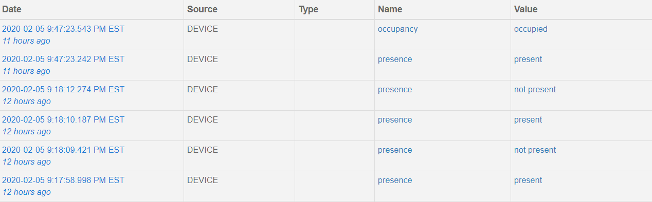

Pixel 2XL toggling present/not present even when I am in the same place
Please see the below screenshot from IDE. Any suggestions? Anyone else seeing this with their phone? I Have a Pixel 2 XL. My wife has a Pixel 2 that has no issues and my mother-in-law has a Pixel 3a that doesn’t have this issue.
The only things I can think of would be that potentially your geofence is too small and your phone’s location is right on the edge, or close. Also, what is you phone’s location services compared to the others (is your location method high, battery saving, or phone only)? Also, ensure any batter saving “stuff” that turns off/on ST or anything for location services isn’t impacting you.

The size of my home area came to mind so I expanded it but have yet to test it (by exiting and re-entering the geofence). Battery optimization is off for the smartthings app.
One thing I thought of after my post was I have both the smartthings classic and new smartthings app installed on my phone. I have since uninstalled the classic app in case they were conflicting with each other somehow. I’ll update once I have more information.

When it says your phone is not present, what location does your phone show if you open up Google maps (or the map app of your choice)?
If I arrive home and my presence doesn’t update right away, just opening Google maps is enough to make my phone check its location, which then gets carried over to SmartThings.
Unfortunately, I didn’t check at that very moment. If it happens again I certainly will. I like the opening the Maps idea if it is delayed for whatever reason…
Did you remember to delete your presence device from Classic before uninstalling it? I’m betting you did since the screenshot from your first post implies you’ve already looked in the IDE and probably didn’t see 2 mobile presence devices for your phone.
Correct, I did. Thanks for the reminder though ;).
Yep. It seems the Pixel 2XL and ST native presence don’t get along well. I gave up and went with Life360. That is reporting presence reliably. Even though my wife’s Pixel seems to be more reliably reporting to ST, I want to move her over as well (and get the teen on it for ST presence plus other family benefits).

It’s there! From the main dashboard, tap on the 3 vertical dots next to the “+”, then tap on Manage Location. You’ll see Geolocation there.
Ha, Thanks. I new I saw it somewhere but I didn’t actually touch the home address to open the map!

Alright so here’s an update. After deleting the Smartthings classic app and expanding the geofence perimeter it doesn’t appear to be exhibiting the same behavior. I’ll update if anything changes. Thank you all for your suggestions.
