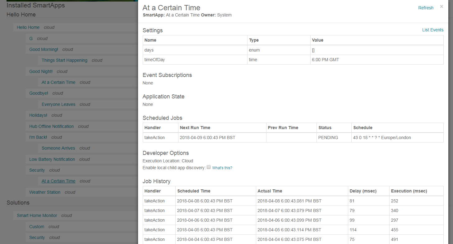

I was browing through my Hub notifications and saw these two lines. Any idea what triggered this?
I’ve no Scenes set up on my account.
2018-04-08 6:00:43.317 PM BST - 5 hours ago Some scenes failed to activate.
2018-04-08 6:00:43.125 PM BST - 5 hours ago Performing "Security" for you at 6:00 PM as requested
ST Hub, UK edition. Nothing complicated in setup - routines as mentioned to set modes, smart lighting to control things, not dabbled with WebCore yet, a few other smart apps but nothing that involves scheduling anything.
EDIT: I did install Vacation Lighting Director yesterday, but its set to trigger at Sunset -15 but only in a Holiday mode which was not active at the time.
I’ve done some more digging. This notification is actually happening every day at 6pm (or has for the past 7 days that logging exists). And its in the Location notifications, not the Hub notifications as I said above.
I’m not concerned about it, but i always like to know whats going on.
Weird. It really looks like a routine, it’s listed with what I assume are the rest of your routines (e.g. goodnight, which is also set to run at a certain time every day).
Support might be able to dig into things and explain how it got added, if you’re certain you didn’t create this routine.
Yep. it does look like a routine, but it was not in the app and I genuinely can’t remember every creating one called that. And I avoid launching the app after consuming alcohol I did wonder if it was SHM related, but it has its own section. Alternatively, i wondered if it was created when i dabbled with the new Smartthings app.
Anyway, I uninstalled it with no issues so far.
There was also an entry called G there (it was basically empty) was also not showing in my app routintes. I’ve deleted that too.
