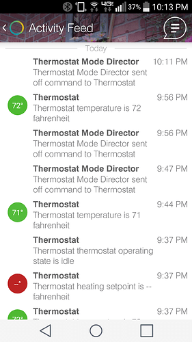

I’m using an official unofficial latest Nest device type. Push notifications turned off though. Using your latest code minus that test mentioned in my last post. I’ll try to think what else might be unique in my setup.

@tslagle13 testing tonight, the temp based hot, cold, neutral parts look good. It worked and no repeating off commands. But after I open the contact sensor/window I do see an occasional harmless repeat off command sent to the thermostat. So the doorcheck may still result in repeating off commands.
I then closed the window, and changed the temp device back to my 47 degree outside weather station temp. Waited a while but the on/heat command never did get sent to the thermostat. The temp didn’t change during this time so maybe no chance to trigger. I didn’t have that much time to test. Just sharing the info. I’ll look into it more on the weekend probably.
The way it should work it it records the last mode and temps for the thermostat. Once you close all the doors it will restore these settings. A command will not be sent again until either the high or low threshold it met. Also, every time you open a door it will send the off command if any of the doors/windows are still open.

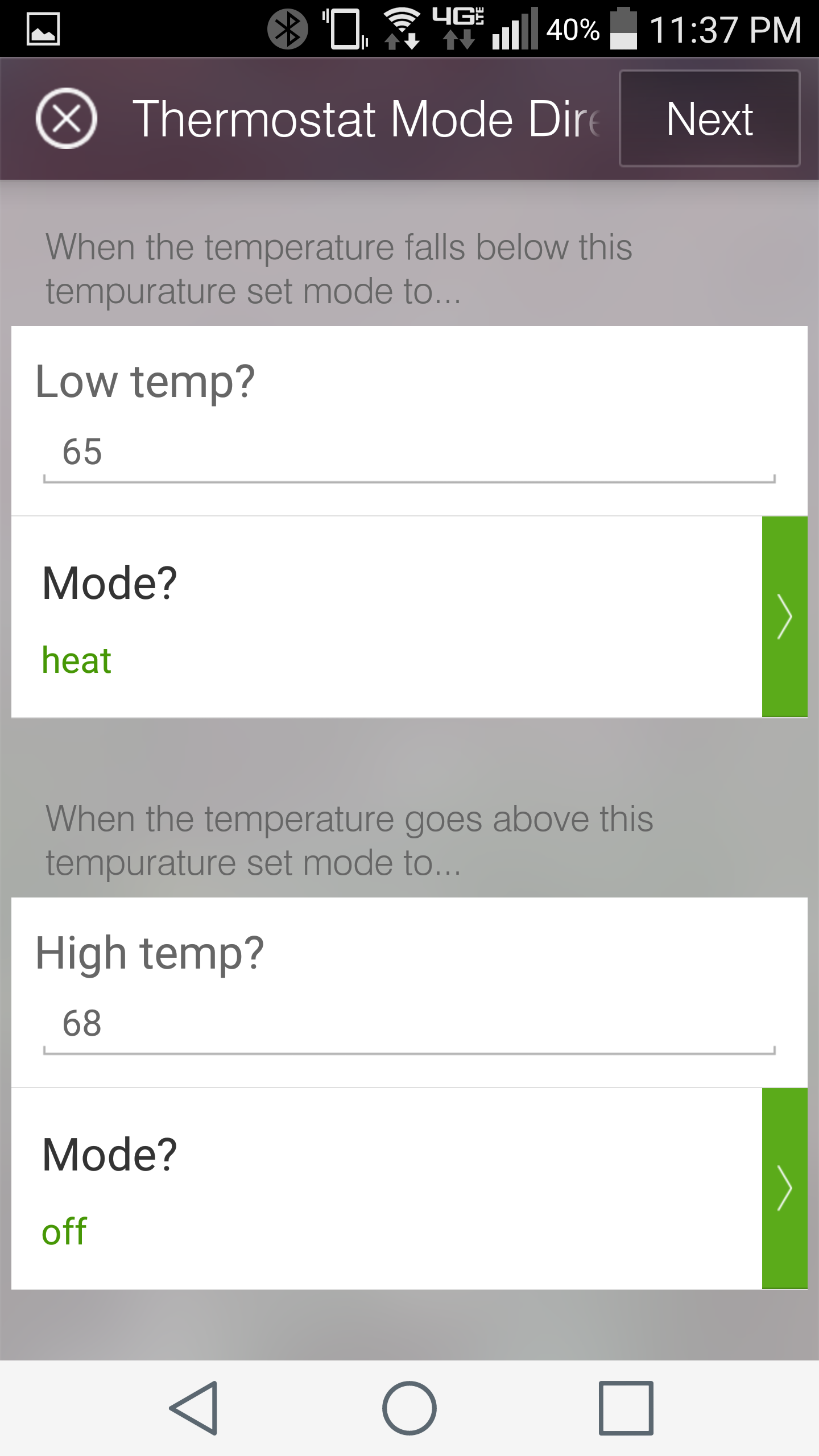

This is great, thanks! I only needed the feature to turn off the thermostat when the doors are open so I set all the thermostat modes to auto and put the high and low temps 1 degree apart.

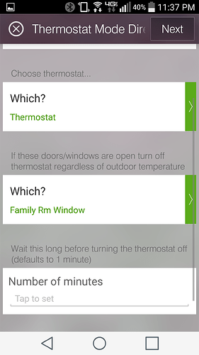

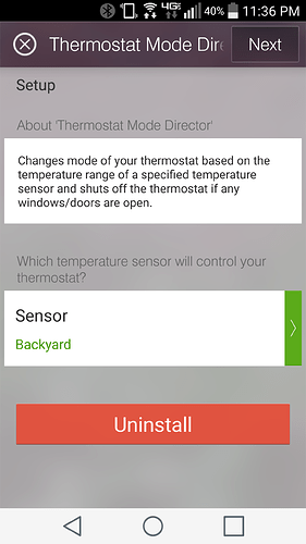

I’m having a slight issue, I have it set to shut off/on the thermostat when the Deck Sliding door opens or closes. The only issue is that it never tells the thermostat to turn back on. It goes into Off fine, but I have to manually tell it to go back to auto. I was hoping that a simple open/close to go onto the deck wouldn’t affect the thermostat, but having the door open for 5 minutes would cause the switch to off, and then once the door is closed again, it would fire up the thermostat. Thoughts?
This is exactly how it works. Check the setup of your app. Also, make sure you’re on the latest version, if not, no guarantees.
