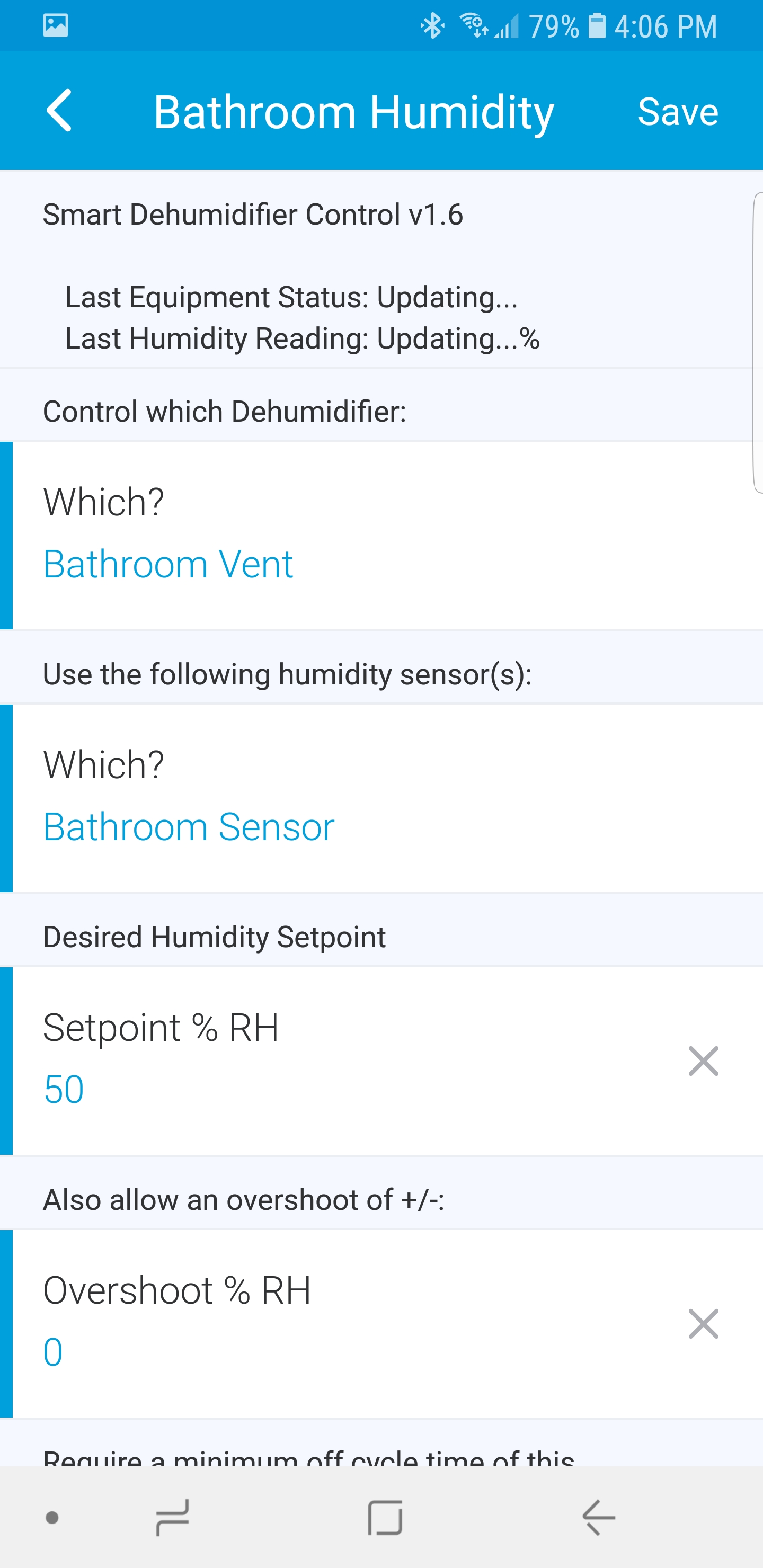

I installed the Smart Dehumidifier control app. on my ST and have Zooz 4-In-1 sensor report the Relative humidity to it. The sensor seems to be reporting the information well (I can see it in the “recently” tab of the sensor) but in the app. nothing happens when the humidity change (I set it up to response for every 1% change). I can also see at the top of the smart app screen that the app. seems to be not getting the data from the sensor for some reason - showing “updating” all the time - any idea? any logs I can look at/share?
So if you are always seeing “updating” then it has to be that the app is not getting the % RH reading and thus nothing is going to work. I’m not sure what you are getting but it could just be the format of the message.
There are some logs and it’s all in the IDE interface. Feel free to post here or DM me if you think it would help.

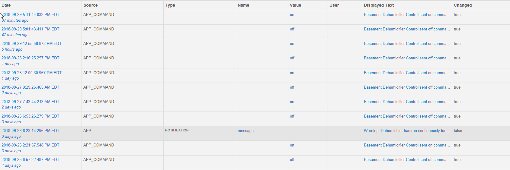

  1. Historical App Log - this is the log that the app generates. Usually not a lot of stuff here but you can see everything that has happened in the last week typically so it is a good historical view. This is My Locations -> smartapps -> [Name of SmartApp] -> List Events -> all. Note that you can also do the same for the sensor and switch devices through the My Devices under each device. You might see something like this:

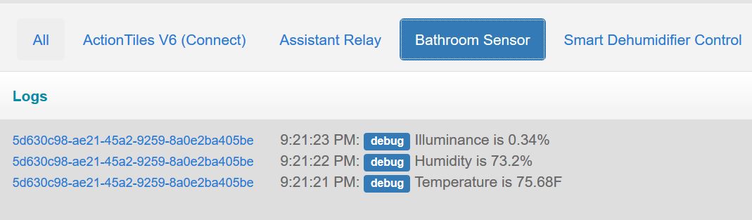

As a side note, I did set manual role in WebCORE and it is working well so to me it seems like the sensor is reporting the data correctly - as you can see also in the attached log screen.

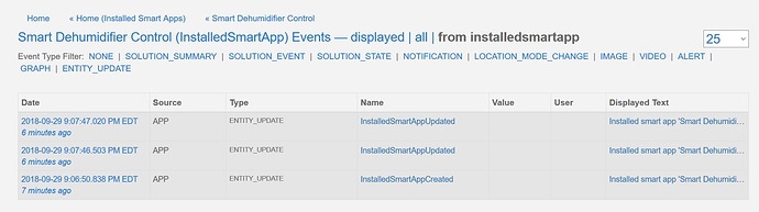

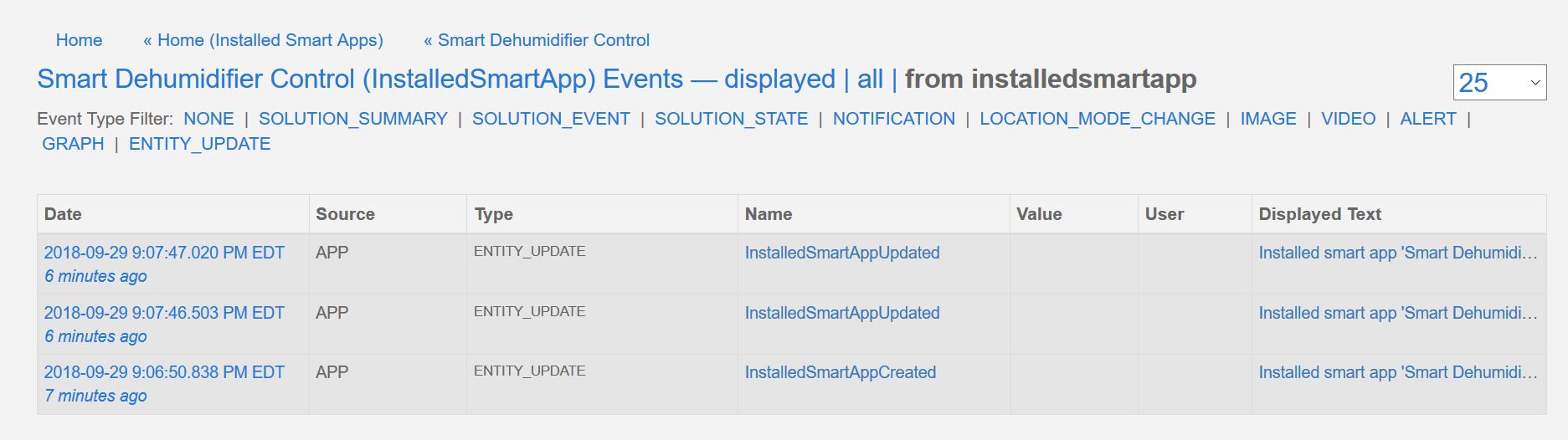

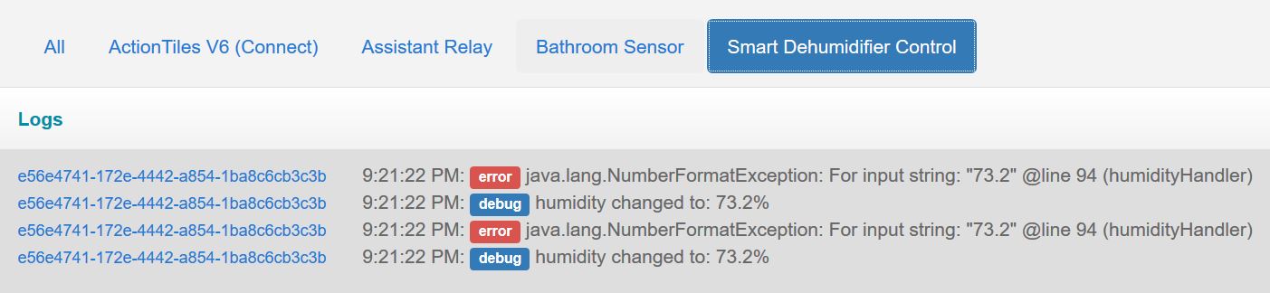

As for the app. , I re-install it again now but nothing is showing since the install in the logs you pointed me to - see also attached screenshot - there are errors in the smart app log (See also screenshots)
Looks like a simple fix with some better handling in the app. I’ll investigate to be sure.
