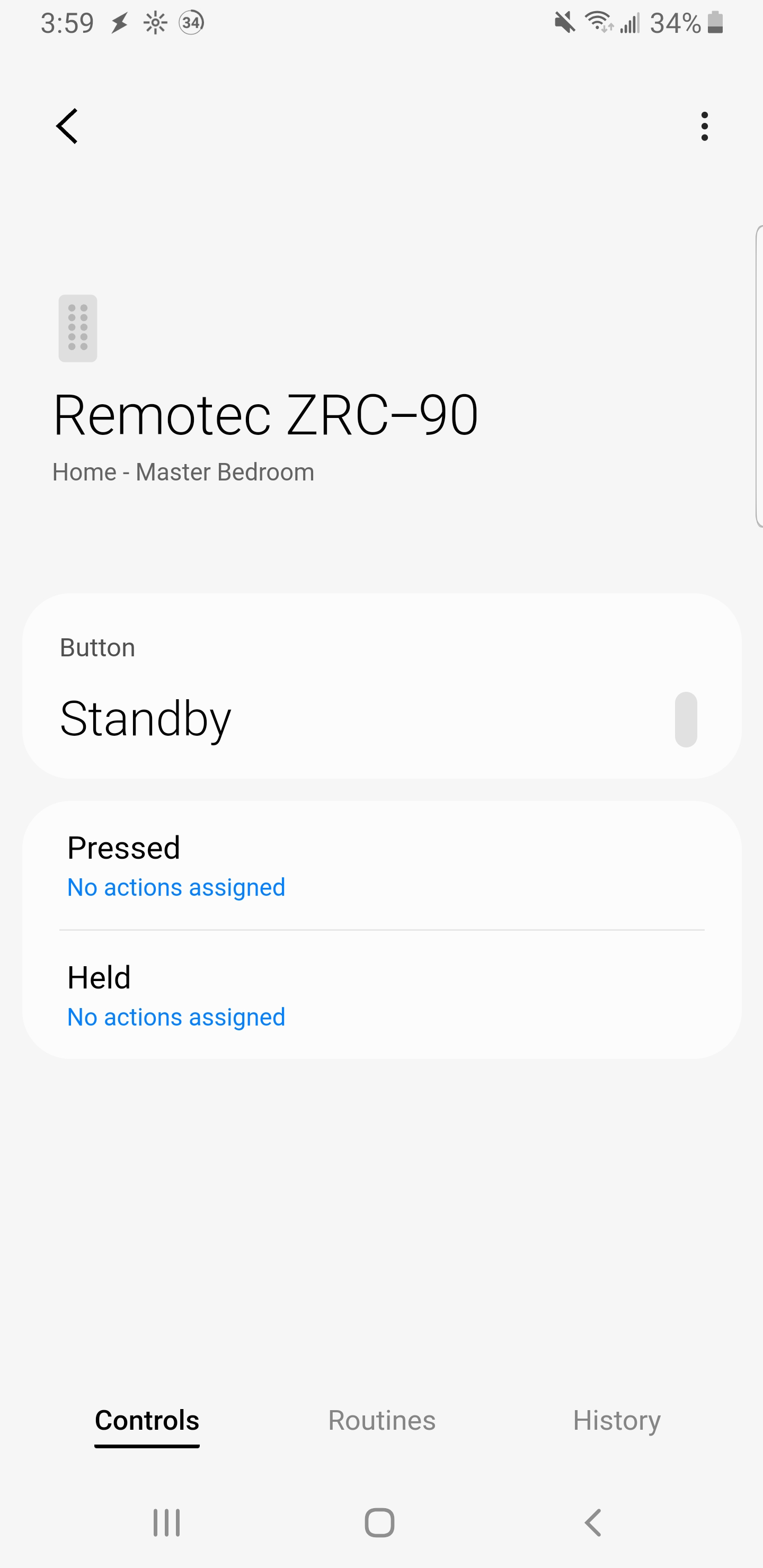

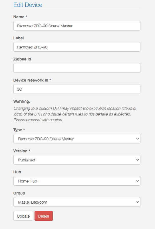

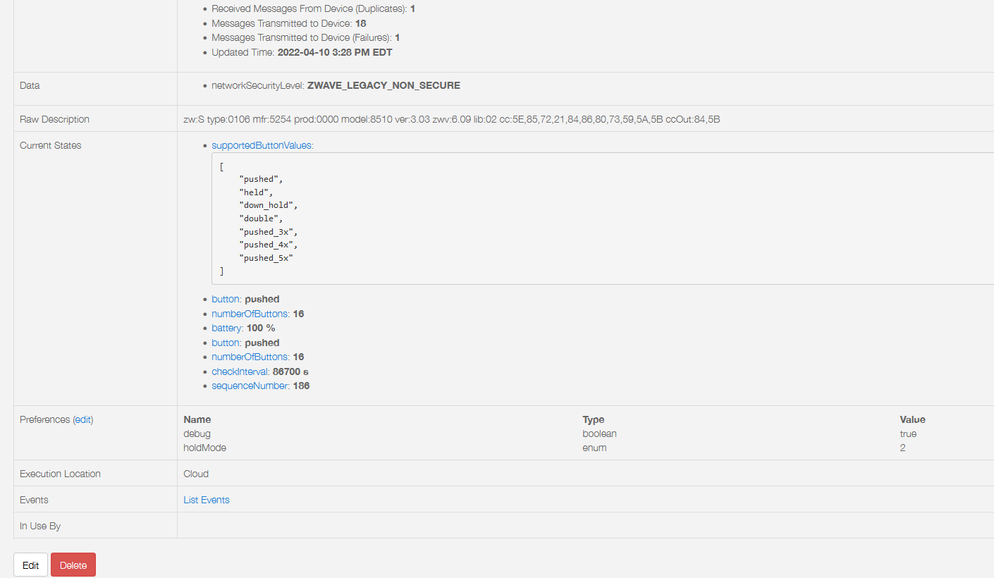

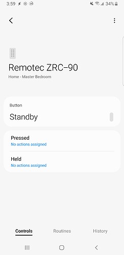

I am having a difficult time getting this added. I installed the custom DH, made sure it was attached to the device. I do not see all the buttons under settings. Anything I can try?
