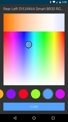

Thanks @Entityxenon Jake, I did realize that after @tomd16 's reply that I had master in the Settings button as opposed to the PlexPlus fork. Just wondering are you using Hue bulbs in your setup? I noticed one of the settings is Hue Bulbs Color, I selected Blue for mine but on my OSRAM Lightify it’s not really the blue as shown here:
Currently, I select the color I want and hope that the bulb just remembers it’s last setting to get the exact color I want since there isn’t a custom option to select a Hue of 59 and Saturation of 67 as shown in the Device Current State:
Awaiting today’s delivery of 2 more Lightify bulbs and 2 new GE Smart Dimmers and this latest theater upgrade will be complete. Thanks so much for this!
I had the same thing happen with me. I’m using the Sylvania bulbs as well. What I did was open up Live Logging from the ST IDE and then I selected my desired color from the app. I looked for the output on the Live Logging for that color. I believe those bulbs rely on RGB, although I’m not sure how you can set it. But what I did do is in the output of that color I saw a Hue & Saturation. I changed the values for a couple of them. They appear to be displaying the proper color now. Here’s a sample of what I changed in the color values.

Let me know if Tom’s suggestion resolves your problem, you can just add as many as you want here… if you want me to add the non hue bulb variants in to the main list I can add them…
Thanks @tomd16 !
Your welcome @Entityxenon! I know for my purposes I’m find with keeping a cheat sheet on the side with the updated colors that work for my bulbs. That way when you update the software I can just copy the colors back into the place.
@johnesc - The good news on this part is you can just change the values in the existing code and then click Save and Publish (For me). It will update your installed version on the fly without having to reload the app.
