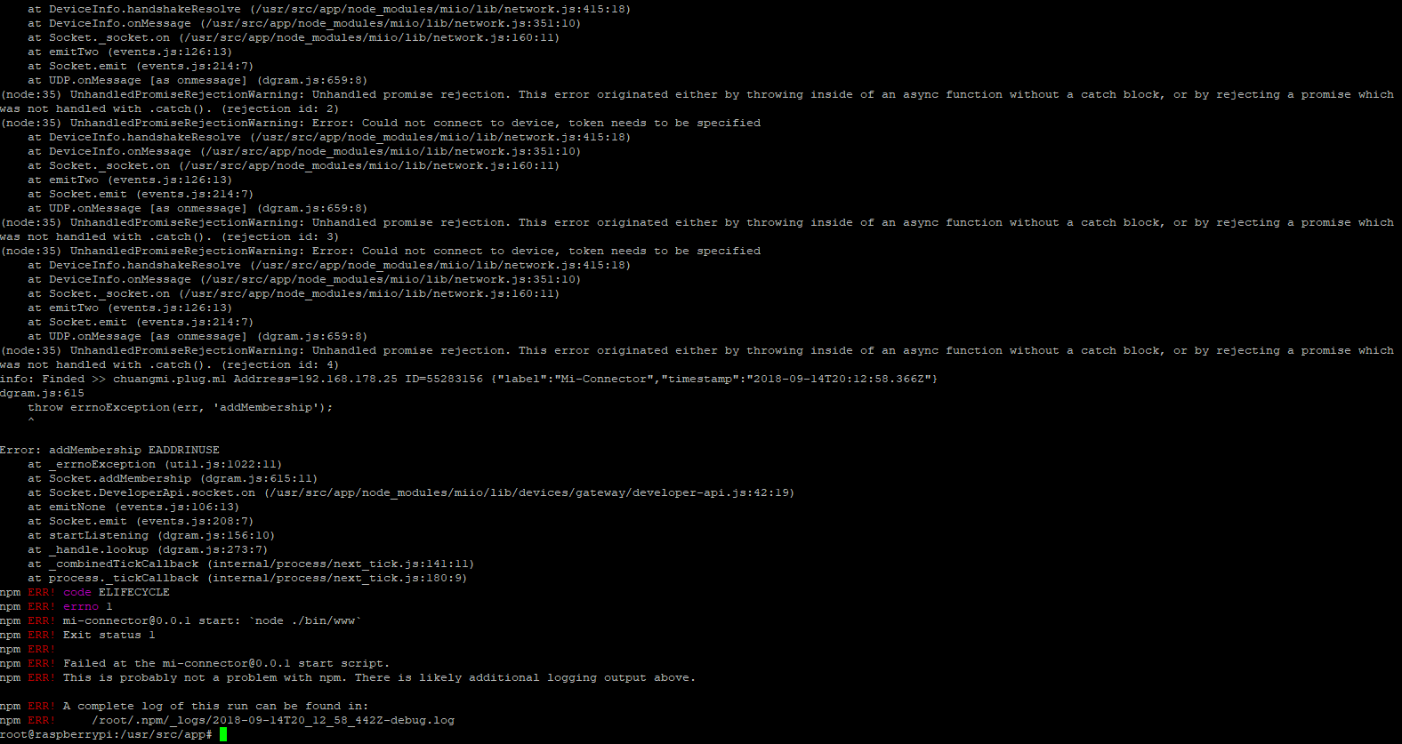

Tried to get it working:
docker run -it -v /docker/mi-connector:/config --net=host fison67/mi-connector:0.0.1 bash
npm start (bash: npm: command not found)
docker run -it -v /docker/mi-connector:/config --net=host fison67/mi-connector-arm:0.0.1 bash
npm start
mi-connector and the mariadb seems to run fine isn’t it?
Really can’t find it what i did wrong…
Everything installed good, no warning/error’s (only one warming at the npm start)
A few days ago i also saw some xiaomi devices where detected in the command promp, this time i didn’t see that.
With what command i let the raspberry look for the xiaomi stuff?
