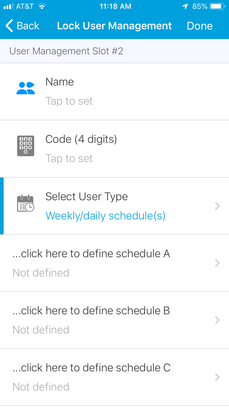

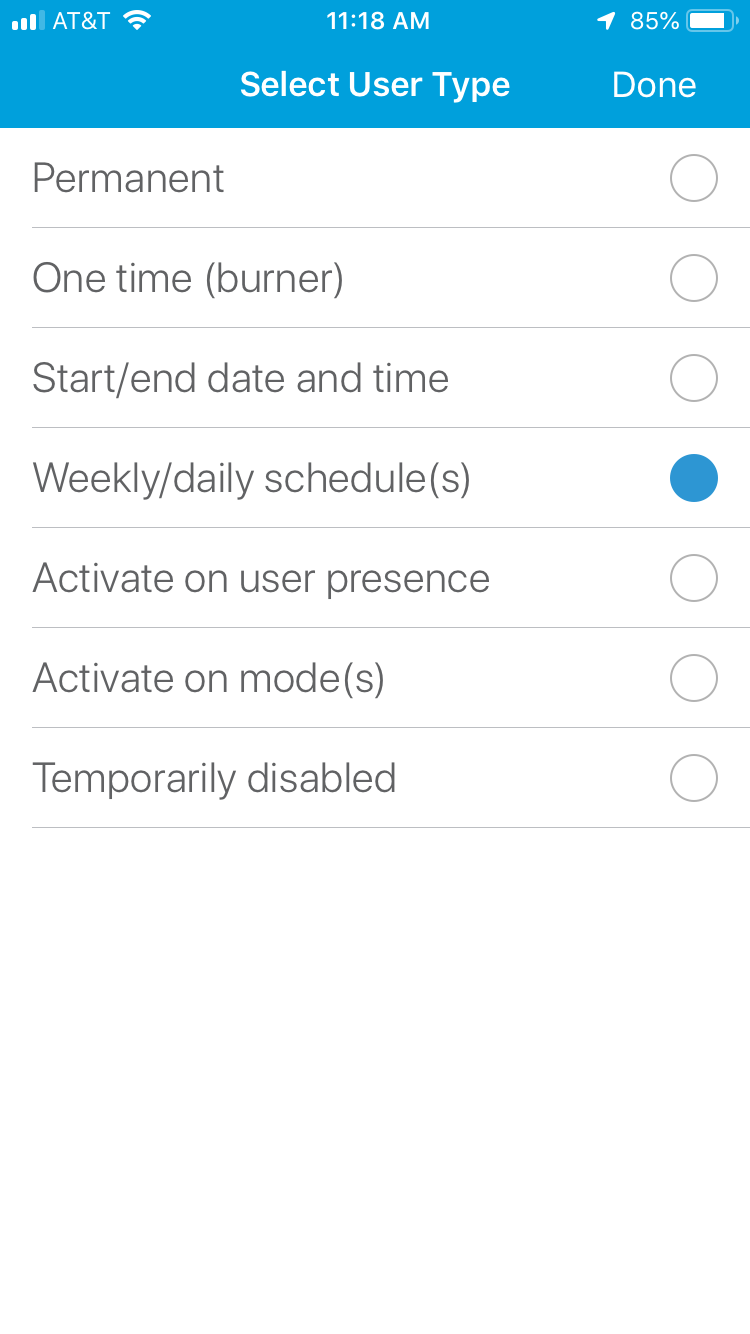

Hi, I downloaded the rboy LUM app so i could schedule when codes can enabled for specific users but I can’t figure it out. I have created multiple codes for different users but there’s no option to create a schedule when that code can be enabled.
Tap on Select User Type and select Weekly/daily schedule(s) and then you’ll see the options to select up to 3 schedules for the user.
Is this the SmartThings app? The attahced image is all i can see. once i click on a specific person/code it
only gives me the option to edit guest name or delete guest. I am wondering if i have the wrong app.
