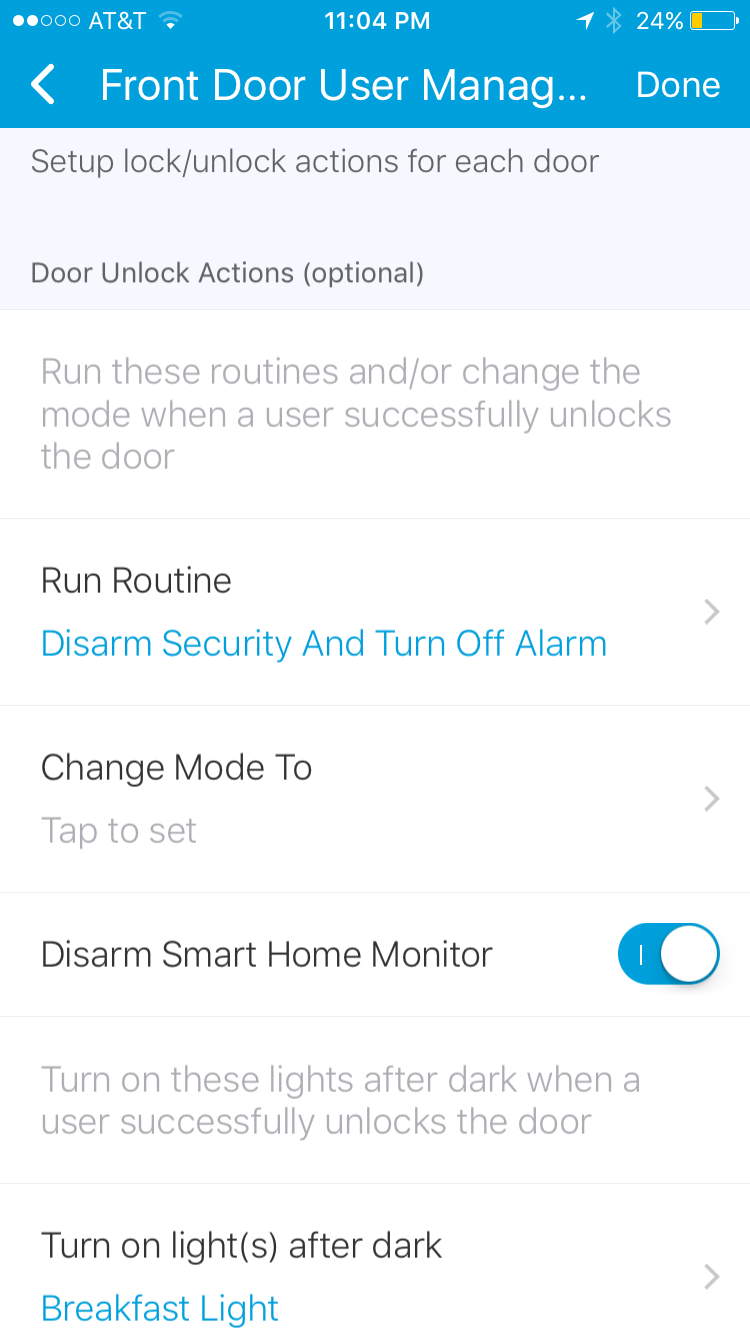

@RBoy ever since I upgraded to 4.6.3 I am having an issue with actions based on lock/unlock. I used to have the lock turn on a light when the lock was unlocked. That option does not seem to exist any longer. When I go into the menu option labeled “Click Here To Define Actions When The User Lock/Unlocks The Door Successfully” all I see on that menu is this (see screenshot).
It’s an issue with your phone connection to the ST servers. Looks like they are running slow and probably timing out while rendering. You should report it to ST support.
Here is what I’m seeing (after a loading delay):

@RBoy I left that page open waiting for it to load and it never did. I deleted and re-added the smart app and it still doesn’t show up. Is there anything else I can do? I need it to disable my alarm and turn on that light, but without getting to that config screen not sure hoot do it. It worked great prior to upgrading to 4.6.3 so this is definitely an issue after I upgraded.
