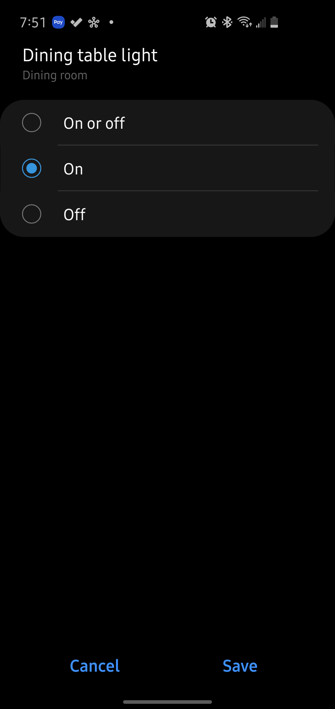

Unfortunately, I still cannot see the additional commands. But fortunately, I am able to use webCoRE to get the desired behavior (setting expression equal to up_2x or down_2x), so it’s not the end of the world!
I’m glad webcore is working, but I wonder why the buttons don’t show in the automations screen. Maybe its because it’s a slightly different device? Anyone else having the same issue? Would be interested in a screenshot of the device in the IDE and any live logs from when the handler is first assigned to try and figure out what’s going wrong. The buttons should show like this with the supported button values:
