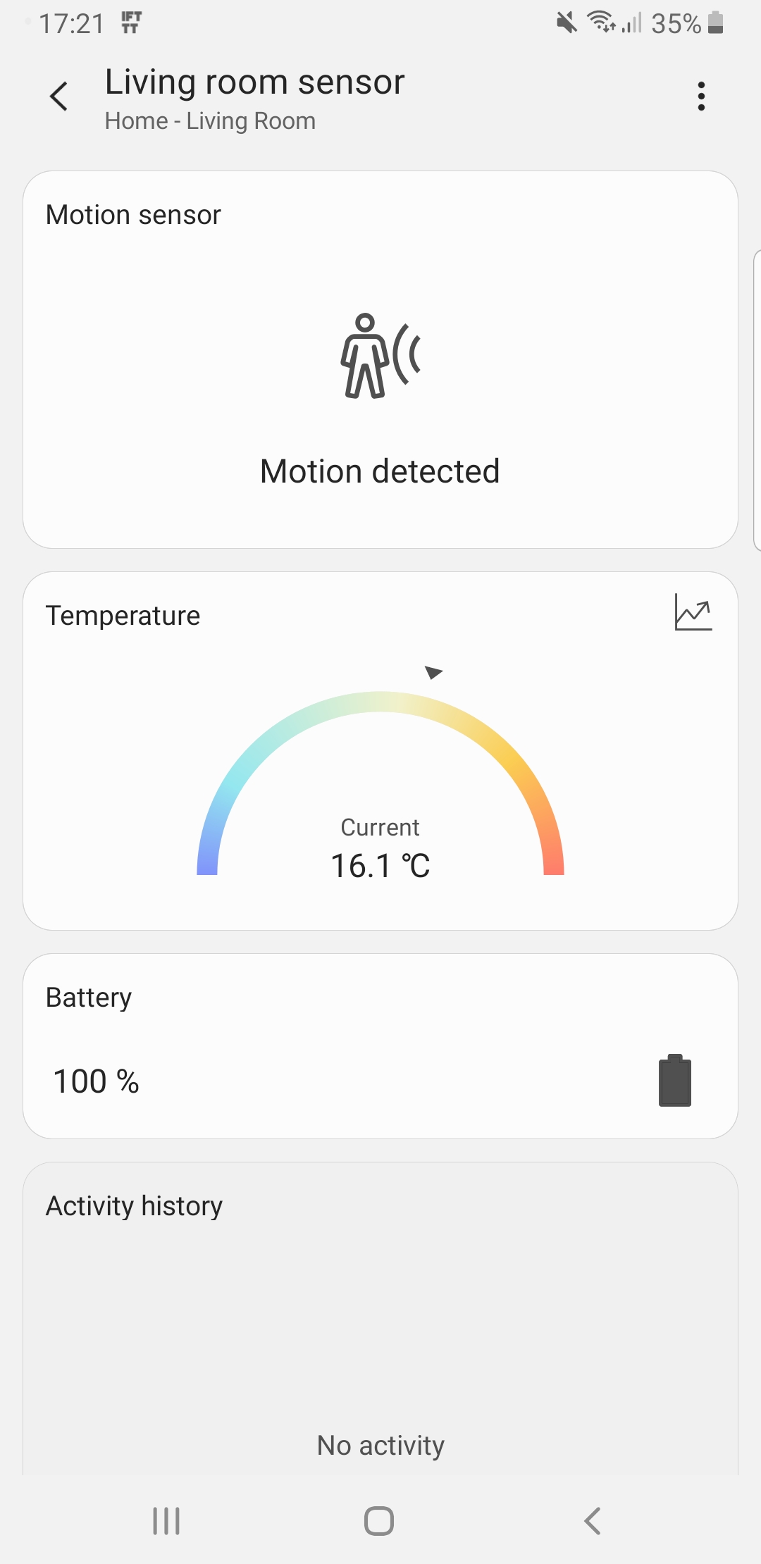

Hi, have anyone succede by adding Hue motion sensor to a ST V3 via the new smartthings app. I have uploaded the device handler and I can’t find anything when I trying to connect the motion sensor. The sensor is in parring mode and blinking amber.
Hey bogdanalexe90 first of all great work and a big thank you for that Custom Device Handler. Now i have a question is there any way to integrate the brightness of the hue motion sensor?
First i tryed an other DH with the Hue motion sensor that had the brightness but was not working in the Samsung Connect App. Thanks for your Reply :slight_smile:
Hi, I have it working with ST V3. But you have to connect/add the Philips hue motion sensor in the Classic app first. After that it should come up in the new app, it did for me!

So I got the Hue outdoor sensor set up and working well in both the Classic and New Apps. I changed the model from SML001 to SML002 as well. However, my issue is that in the New App it shows up as a Contact Sensor, not a Motion Sensor.
Is it just the New App being strange or is there something I need to update in the DH. It correctly shows up as a Motion Sensor in the Classic App. Thinking I’ll just have to wait it out.
Hi @bogdanalexe90, I added the sensor using the newer Smarthings app, but the luminance sensor isn’t displaying in the device screen. In the classic app the device is displaying the lumiance and is updating depending on light so can tell it’s working. Any ideas why the two different apps may show different details?
