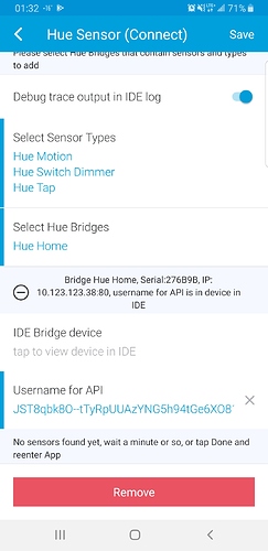

A few days ago I cleaned up my Hue bridge authorizations (thought myhue) and now I have troubles getting the Hue Sensor (Connect) operational again.
I already removed the app from IDE and the phone-app and started over, but each time I enter the Hue Bridge username (grabbed from the IDE) the phone app seems to freeze and nothing happens.
The next time I try to open the smartapp on my phone I gives a message: “er is een fout opgetreden. Probeer de smartapp opnieuw te installeren.” Reinstalling doesn’t solve the issue, tried it several times.
Live logging in IDE after install and after tryping to open the app on my phone:
4:35:10 PM: error java.lang.NullPointerException: Cannot invoke method indexOf() on null object @line 977 (pollRooms)

My location > Smartapps > Hue sensor connect, it also finds no devices:

I’m trying to install this for the first time but after I add my bridge username the app freezes up, I can’t get back into the settings and can’t connect anything.
Seems I’m not the only one having issues, has anyone found a way to resolve it?
I am experiencing the same issue that I think @lenabanana is experiencing. I can add the hub to the Add New Things, it shows up in SmartThings Classic app and in IDE, then when I go to add it to the Hue Sensors App, it crashes.
The only way to fix it is to force remove the Hub from SmartThings Classic App.

Your app is fantastic and did work very well for my for some time. I need a way to keep the Hue Dimmers connected to the Hue Bridge but also connected to the Smartthings app which you had managed. I’m having the same issues as others now, I’m getting the message 'Error saving unnamed page. Please contact SmartApp developer". Any ideas if I can fix this somehow? I appears after typing in the ‘Username for API’. Any help would be welcome.
