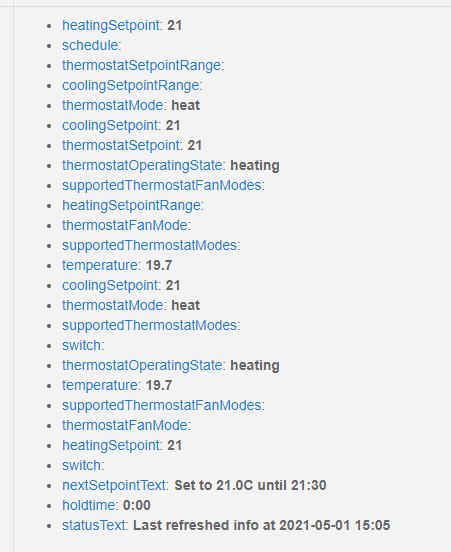

@fido - Ive spent almost two hours playing with various attributes to try and give Alexa the information it needs to display correctly but I just cant work out what is missing. If you have a Thermostat device that does display correctly then it would be great to see this panel as I assume it must be an attribute that Alexa needs to display information… It could be a missing command, but Im sure Ive copied all the potential commands from 2 other thermostat controllers (so I assume they dont work either…).
Afraid Im going to have to accept defeat for now as I cant find any documentation anywhere and have reached my limit of time to poke around, especially given that the control functions work fine (i.e. you can set the temperature correctly and query it). But if you have one that works I can use it as a template.
