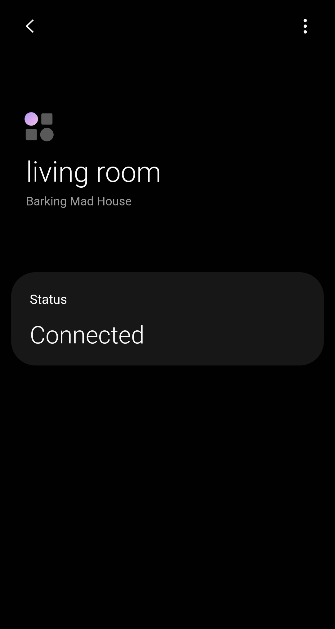

If you could update or add the latest screen caps to the original post Chris it would be really helpful, I just noticed the screen cap you have of the hub has information but that was for ST classic, does the current ST app and subsequent neo bridge device page have information ? Mine just says connected
